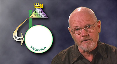

I'm working on a project and have just has a line apppear in the video as seen behind my head (see photo). The line is the full length behind my head and in this case his showing a section of my green screen. However at other places on the time line it shows the colour of the backdrop only in solid colour, not with a cloud effect.
I have been through all the video tracks switching them off and on to see if I can isolate the track. I though it was one with track motion on but am not sure about that now.
I have closed the the project and opened it again and it is still there. I have closed Vegas and reopened it and it is still there.
Any thoughts on what could be causing it?

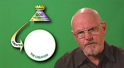

I've attached another screen shot to show it in a different part of the time line...this time it takes on teh colour of the background and goes infront of the glow (track motion) but behind the arrowhead, and behind the rest of the image. The arrow is higher on the track stack than the rest of the image

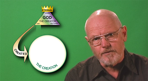

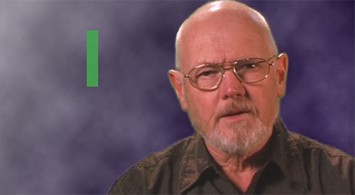

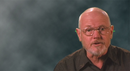

Here are three more screen shots of another bar, the other one I referred to...hmmm
In fact...the bar shown on the other two screen shots is no longer there...
When switching on chromakey in each of the three main green screen angles, this green bar is there.
When the graphic is on screen by itself the bar is not there, but when it is on screen in association with the green screen shot it is.
