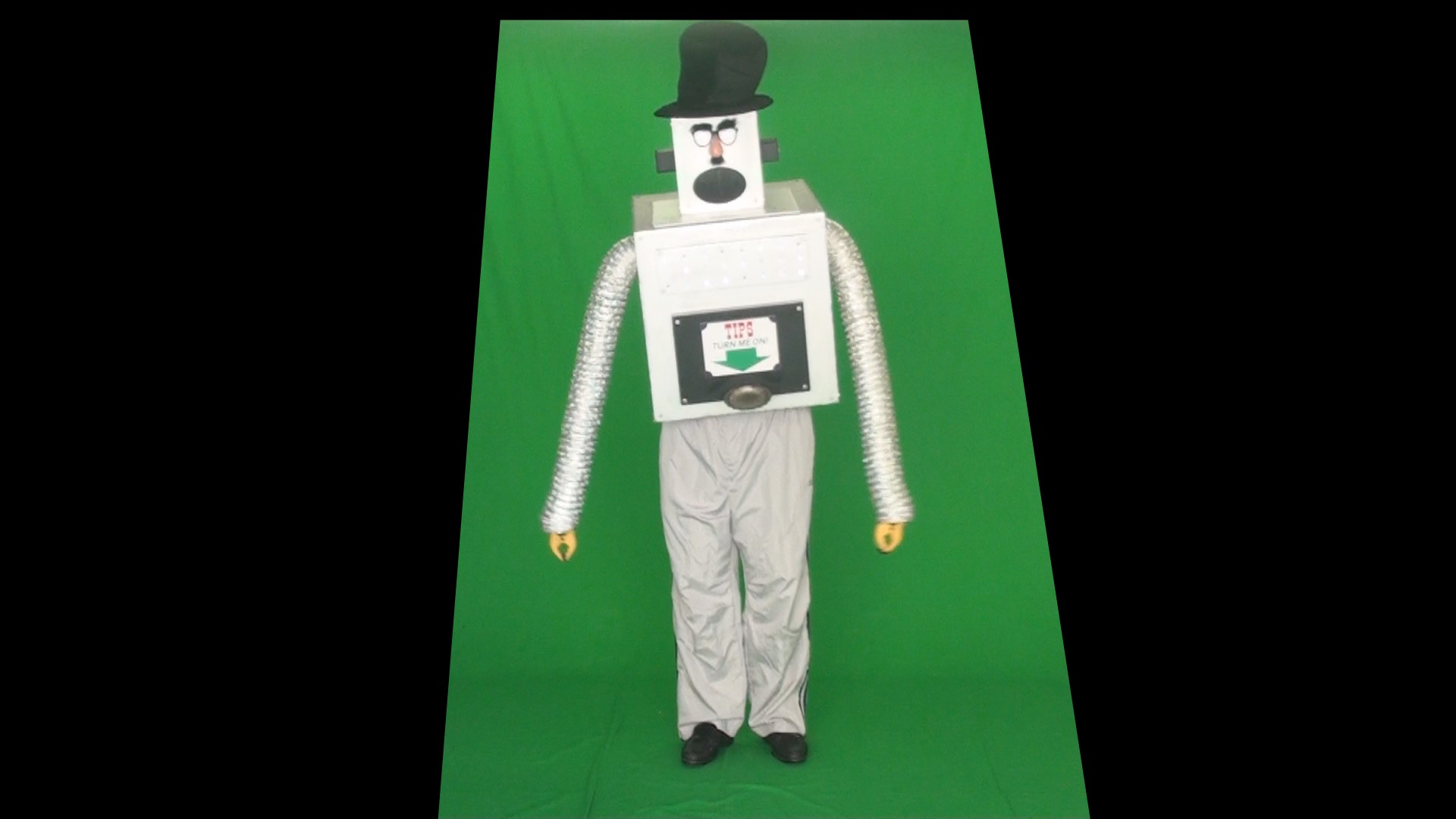

I've been shooting green screen with white balance set.
However, now I've noticed the front of the character's costume has been whited out from a strong reflection.
The flashing lights are now completely gone.
I was wondering if any gurus knew how to somewhat correct this blowout.
Pic attached below.
Running Vegas Pro 10c
Thanks for a clue

Wouldn't regard myself as a Guru, but I'm certainly needing to see exactly what your BEFORE and AFTER is about.

Hi Art
Take a look at the footage in Vegas with scopes on at look at your white levels ..They are probably way over the top as you say so try pulling the white levels down with the levels plugin.
I don't really know why this also works but if you put the invert plugin into the chain first and push the slider all the way so the image is totally inverted (the whites will be black) and then put the level plugin following by a second invert plugin set the same at the first one it seems to work better when you correct the inverted image. It could of course be so blown out that you have lost all detail but it's worth a try!!
Your plugin chain should be (left to right) invert - levels - invert
Anything is worth a try and that's what I have used when I have had a bad backlit scene with the sky perfectly exposed and the subjects in deep shadow so it might work the other way around too??

Difficult to see from attached image but my take would be to address this in production not post. It looks to be lit with just 2 lights, my suggestion would be to use 2 lights for the GS, bring the subject away from the background and light it separately, expose for the subject and then balance lighting / exposure for the GS.

Ok
Here's an HD still with green screen in the hopes someone can bring out still more of the robot's lights in Vegas Pro.

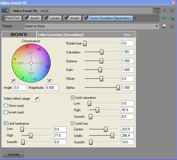

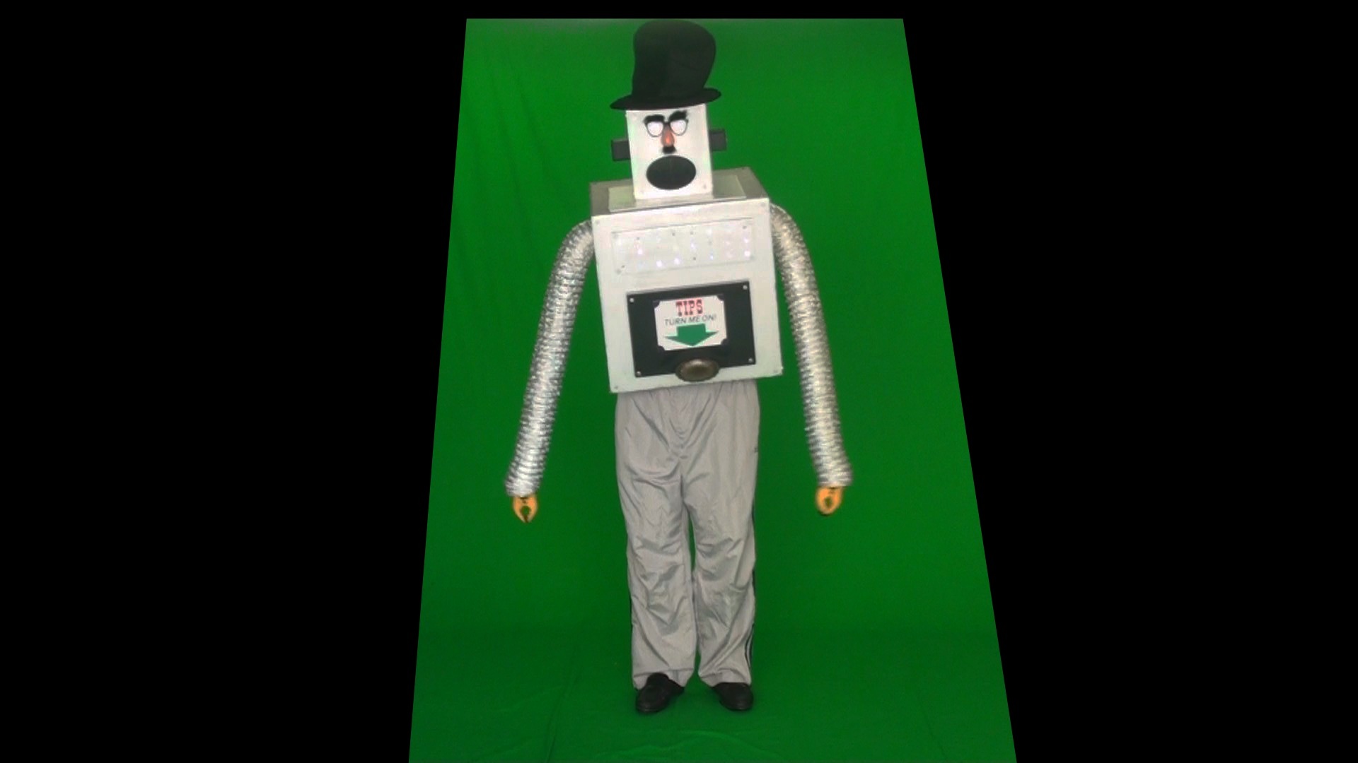

Art, here's the details on the "trick" that Chris referred to.
I tried it and here's my attempt at it as well as a screen shot of the FX chain. FYI, I set Gamma to 2.0 on the Levels FX.
Put 3 filters, a "Invert" (at 100%), "Color Corrector", "Invert" (at 100%).
Then lift up the gamma of the color corrector in the middle.
This darkens highlights first, in the logarithmic fashion, more like a "iris closing" way.
You can also put a color corrector secondary to select reds and lower the gamma a bit. (This suggestion was meant for the image being discussed on the thread below).
Dark or bright may also have to add or remove a bit of saturation on the color corrector filter.
Help with Over Exposure!
