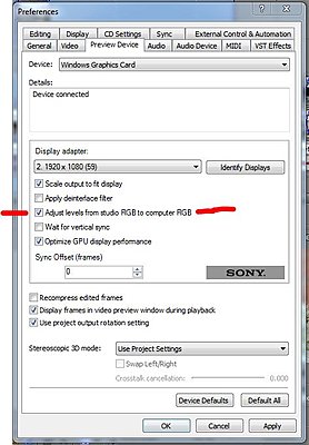

I've been reading and learning about this for maybe 10 years now, and what it mainly comes down to is the crucial way Vegas displays the Media in Preview and the output from your camera/device.
Here's the thing: Vegas will show you EVERYTHING about your footage. It wont change or adapt anything. Some people do NOT like this, others say this is how it SHOULD be.
OK, appreciating that this state of affairs IS the status quo, you/me/us have to keep an eye on the workflow and design-in within that workflow what our final output will be: INTERNET - DVD platters - Projections. All of these, maybe more, and as you have discovered, require their own particular render "Levels" Treatments.
Oh yes, do NOT forget your Monitors either! They also have the option in Vegas to have a Levels FX added to them:
