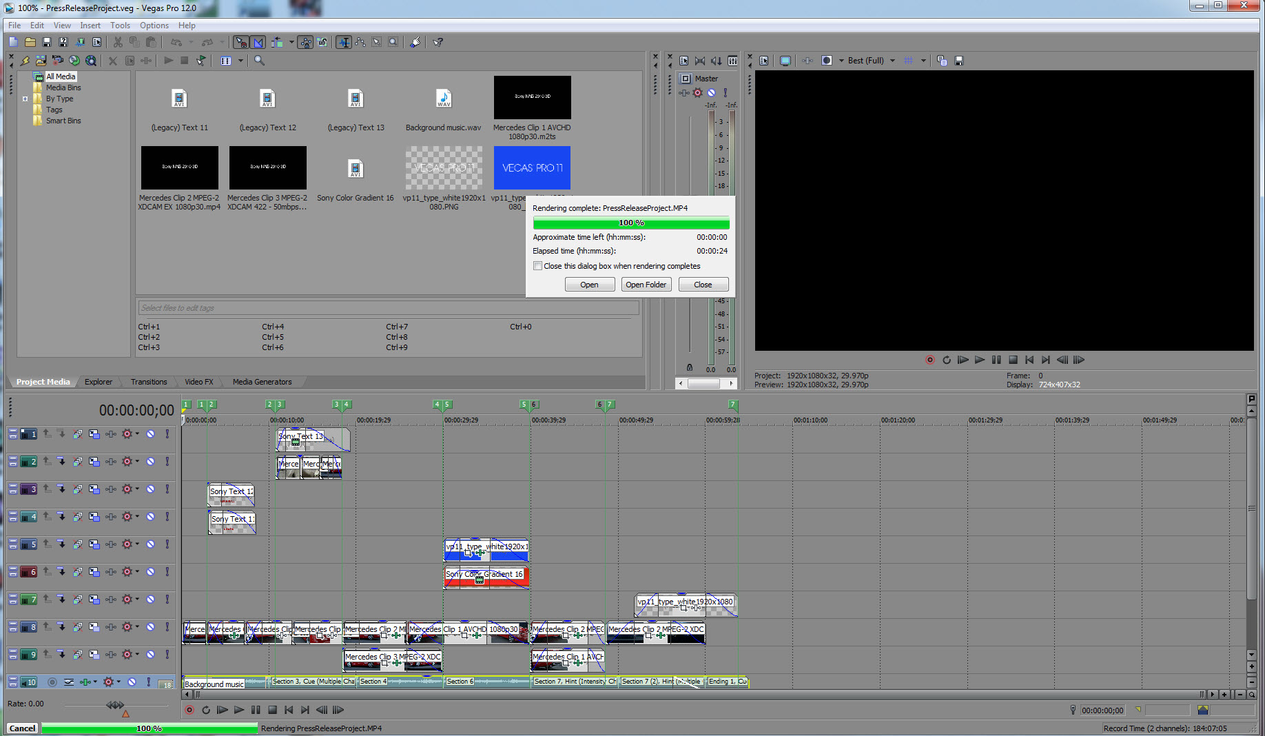

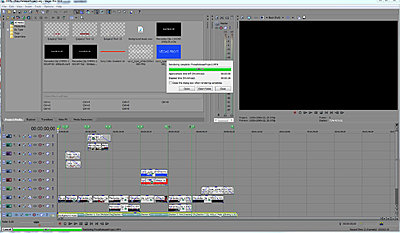

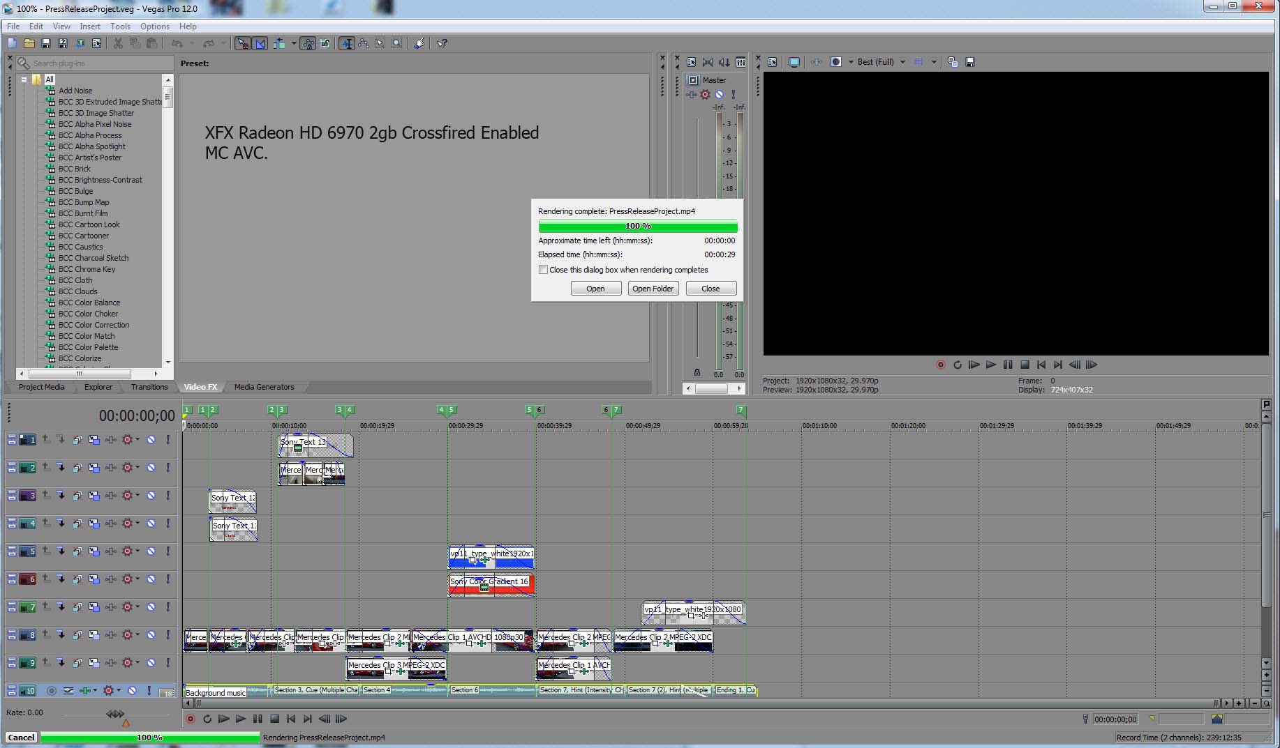

I love my HD6970 work great in crossfired with 3930K @5.0Ghz. Now, I run 2 R9 290x crossfire with 4930K @4.5ghz all work great to.. A single R9 290x render Sony Benchmark in 24s. 2 HD6970 crossfired rendered in 26s and a single HD6970 rendering XDCAM in 36s. See thread below.4K editing. You can download the Sony Project Benchmark and test your Graphic card see how is your video card perform.
Sony Creative Software - Forums - Vegas Pro - Video Messages
Best Graphics card for V12-crossfired-6970-2-gb.jpg   Best Graphics card for V12-36s-xdcam-benchmark.jpg
