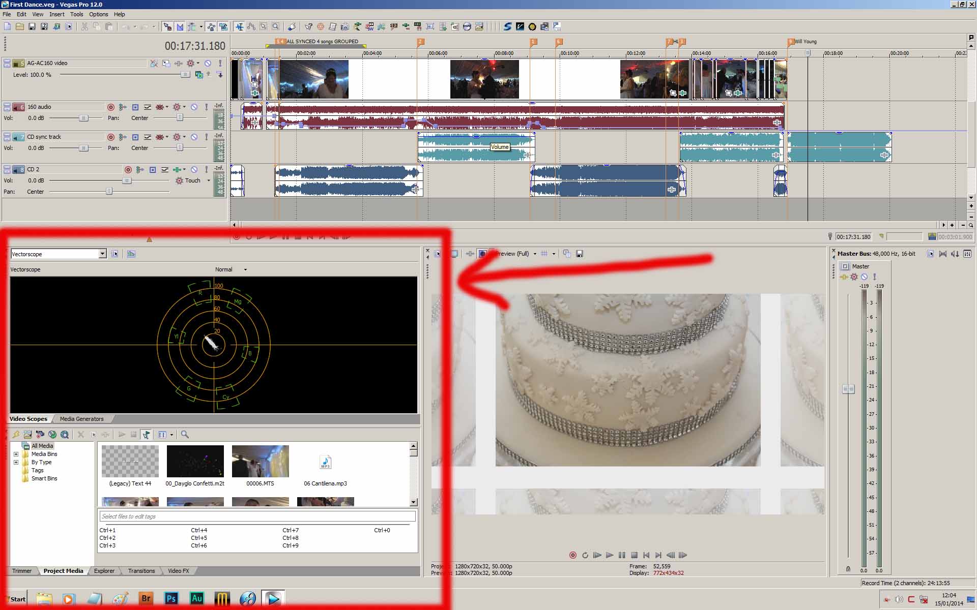

As for the docking windows, I do wish I could get rid of Vegas' ability to make horizontal windows, I really don't want this, just the original method of having vertival docked windows side by side so that you just clicked on the relevant tab. It's enough to make me think about reverting back to V11.
I've attached a screenshot showing the problem area.
Hope someone knows how to stop this.

No, that isn't the problem really....it's having two windows, one on top of the other, which wasn't in Vegas 11 or earlier. You just had vertical window columns then, each with their own tab when docked. That's what I'm trying to get back so the windows don't sit on top of each other like they are in the screen grab I posted earlier.

You can still do that in Vegas Pro 12. Just drag it to the upper-left corner of the window you want it to tab with.

Thanks Edward, I have been doing that but anytime I then open a new window, it seems to default to the new method of two windows, one on top of each other which is what I'm trying to over-ride. Just checking out the layout in Vegas 11, that wasn't possible in 11. I guess if V12 has no way of stopping this, then I'll have to go with it....just wish there was an option to turn it off.

I was just having a look at the Sony Vegas site Vegas Pro 12 Workflow and half way down, it reads "NEW! Vertical Docking Windows". That is the feature that has been introduced to V12. That is the feature I want to stop if possible.
Sorry to be a pain, guys, but it really does drive me mad. All help gratefully received.
