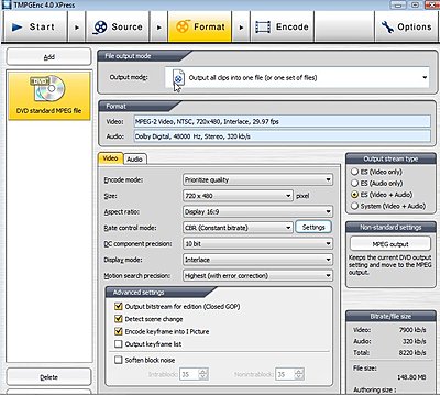

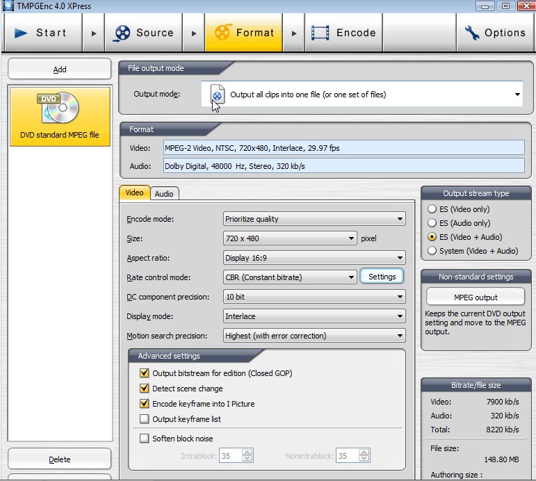

Jeff, I use a different editing system than you but I have no problem getting beautiful DVDs from 1080i footage. Of course this was after wasting much time experimenting with various encoders. One of the big image quality problems to deal with is downscaling from 1080i to 480i. This is where most low cost encoders fail to produce a decent image. After trying various encoders I found one that works best for me.
Here is my workflow. Export a lossless .avi file from your 1080i timeline (I am on Edius). Bring it into TMPGEnc encoder. I use TMPGEnc 4.0 Express that has now been updated to Video Mastering Works 5.
You can download a trial copy if you desire. Use the DVD encoding template and let it do the work. My settings for a duplicated DVD-R is in the attached screenshot. I normally do replicated DVD projects and the only difference is I raise the video bitrate from 7900 to 8500 and the audio on top of that for the master. After 5,000 DVDs sold not one complaint.

Mark, many thanks for kindly posting your detailed workflow, including your settings. I have read nothing but good things about TMPGEncoder.
Happily I can report that my DVD lnow ooks very nice. I was previously judging results by playing back in DVDA, which I can now see is not the way to judge interlaced video.
On my 72" screen it looks very very good. It does seem to be agreed upon by many that interpolate is the way to go, as Mike suggested, but apparently some Vegas users use the Blend option instead. I will use the blend option next DVD for the first draft and watch it on my TV first rather than judge it by my PC monitor.
