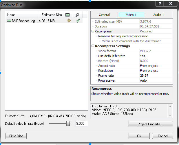

When I use the DVD workflow above, DVD Architect Pro 6 gives the following messages:
"The video on track 2 will be compressed.
The audio on track 1 of 'myvideo' will be compressed.
The end action of 'myvideo' uses the most recent menu command before a menu is reached. It will link to the top menu or stop if no menus.
The remote button action of 'myvideo' uses the most recent menu command before a menu is reached. It will link to the top menu or stop if no menus."
Why is DVDA compressing the video and audio? I thought the purpose of creating an MPEG-2 render (step 3 below) was to compress and properly format the video for DVD creation. I’m I missing something in the workflow steps?
The video output file from step 3 is .mpg. The audio output from DVD step 4 is .ac3

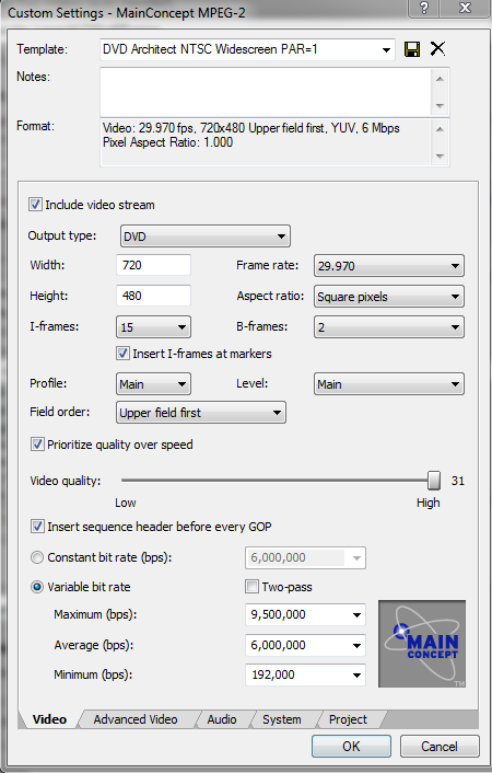

For step 3c the vegas render template has the PAR = 16:9 (1.212). Should this remain at this setting? I changed it to Square (1.0).
<see dvd_PAR1.png>
DVDA settings
after making vegas render from dvd template .mpg DVDA gives warning that video is non-compliant for dvd standard.
<see DVDA message.png>

You are messed up with your PAR Mike.
1080p out of vegas,
Down res in V dub to square pixel version of your PAR of your final mpeg,
So, 1.212 x 720 = 872.64. You will need to tweak this a little to accommodate any pillar/letter boxing that occurs, eg For PAL we change from 720 to 704.
Then drop your 872 x 480 avi into a new NTSC DVD vegas project (DVD Architect widescreen template, dont change PAR) and compress to m2v .

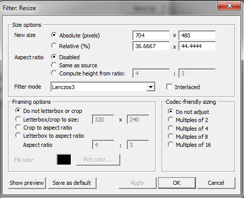

Juris, Can you help me understand this?
What should i resize to in VirtualDub? 720x480 or 704x480?
Is it better to stay progressive and go to 24p? Or use 30i
For 24p and 30i, when is that change made in VirtualDub or in Vegas during the MPEG render?

I'm from PAL-land and use only 25i.
Diference betveen 704 and 720 is in the aspect ratio - 704 contains only active part of a scan line, 720 must contain place for the blanking impulses. I don't know correct pixel aspect ratio for NTSC DVD. In PAL it is 1.4545 for 704x576 and 1,4568 for 720x576.
In result, 704x576 have frame aspect ratio exactly 16:9, 720x576 is small wider. When playing DVD on a consumer player, picture must look exactly the same.
