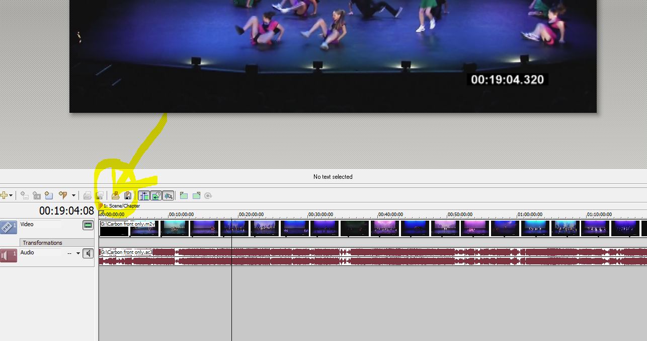

Tried the script, thanks Mike, it makes a file, but when in DVD Arch it wont import, I'm clicking this button, see pic, yeah?
I named it exactly the same as the vid file in same folder.

After you render with markers, and after you bring the movie into DVDA, double click on the movie icon in DVDA on the menu, and it will show you the markers on the timeline in DVDA.
Where are you referring to here Jeff?
Gee, should it be this hard.

Gerald, yes that is the load markers button, can't be sure what is happening, or not happening.
