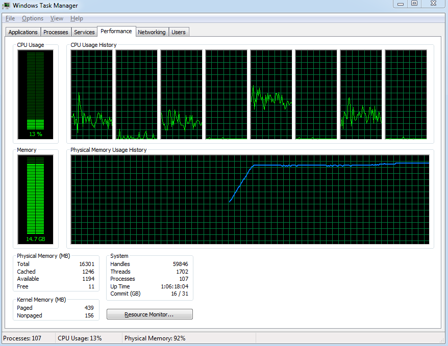

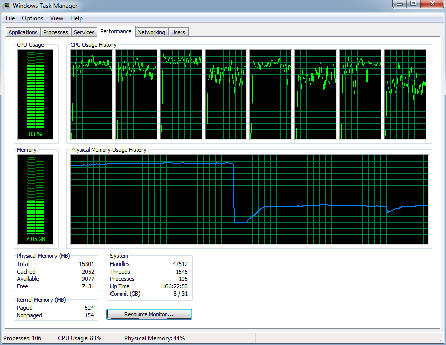

Jeff I don't understand this either, completely whack. Here is a screenshot of a Vegas render compared to an Adobe Media Encoder transcode. Fan is secured properly, temperatures running at 41'C.

Nick, install and run CoreTemp and do a render, and see how your temps run on all your cores. If they are uneven by much then you might need to reinstall your heatsink. This will at least give you more info to work with. I only recommend this because it happened to me. My renders were fine, but my core temps varied a lot from core to core, and I could figure out what was up.
It so happened I bought a new cooler for my CPU, and when I removed the old one I found I hadn't fully inserted one of the heatsink pins properly previously, and my thermal past was very unevenly spread to boot. I have installed heatsinks, CPUs a number of times, but really screwed it up that time, apparently.
When installed my new heatsink/cooler, the temps were much more even across all 6 cores. Not very scientific, but if this can help, you might try it.

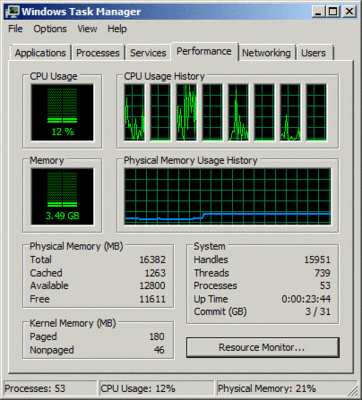

The image of your TaskManager means you may be running single-threaded code. 12% means one thread on a four core hyperthreading CPU. The threads jump around from core to core. They don't just sit in one core. The image below is my CPU running a single-threaded instance of Prime95. Other things going on in your computer can add a few extra percent beyond the main thread. It could also be multi-threaded if the chokepoint is somewhere else than the CPU.
If your rendering is slower it could be because it's using the GPU for rendering and it's slower than your CPU. Vegas 11 made substantial changes to the amount of GPU support. You can tell for sure by getting a GPU monitor utility. Just google for "GPU monitor". There's tons of them. So if your GPU's getting hit hard and your CPU isn't then tell Vegas to use the CPU instead. I'm not sure how. I'm running Vegas 10. There's also an option in older versions of Vegas which allows you to limit the number of threads. But I don't see how that would change without you doing it manually.

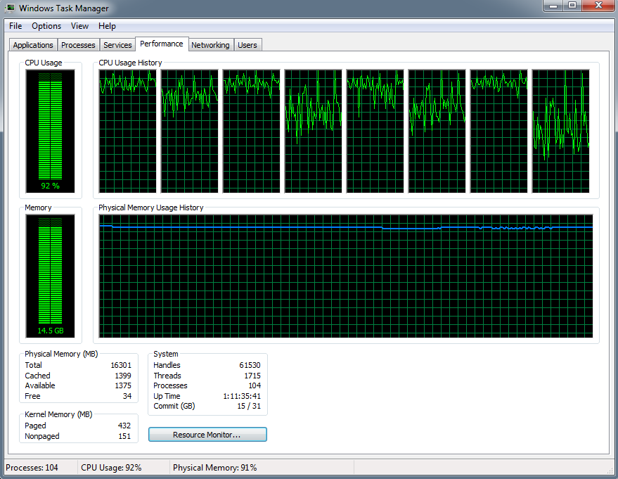

Mark you where right about the GPU doing the work, I disabled the GPU in the preferences of Magic Bullet Looks & I now have full CPU utilization....but....
I then did a render with the GPU enabled/disabled & the GPU kicks the CPU's ass even though it's an Intel 3.40Ghz i7, the GPU rendered in half the time. This makes me wonder, if I put two graphics cards in SLI will this improve render times? It appears that the CPU isn't that important after all when using Magic Bullet Looks, spending some money on a proper high end graphics card might speed up my workflow.
I'd ask Red Giant. I've seen people asking about GPU acceleration in Vegas with multiple video cards and haven't yet seen a definitive answer. And it may be specific to the plugin. It's mostly gamers who have SLI rigs so I guess there's not that many people around who can test it.
With all the GPU acceleration being added lately there's definitely an advantage to a high-end video card. But it seems awfully specific to exactly what you're accelerating. Some things are faster on the GPU and others are faster on the CPU even with a fast video card. Personally, I've always gotten one faster video card rather than two slower ones. There's just too many situations where two in parallel are not used very effectively if at all.
