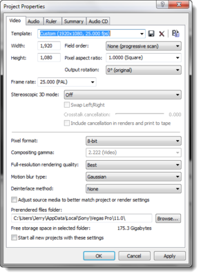

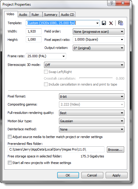

well.. the Canon HF G10 shoots 25p in 50i, does this mean I still need to deinterlace?

Federico,
I'm pretty sure if you set up your project properties as shown in the attached image, you should be fine. However, I'd highly recommend a short test with your camera and a test render - just to be sure.
...Jerry

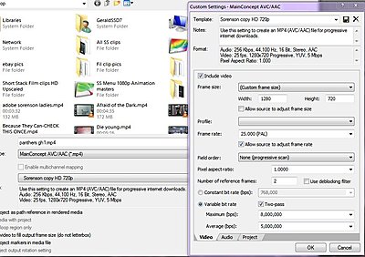

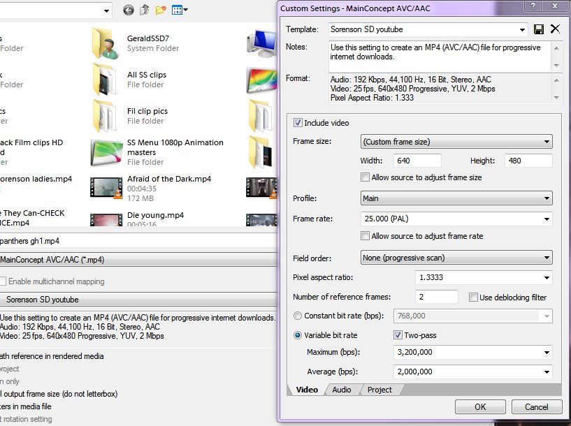

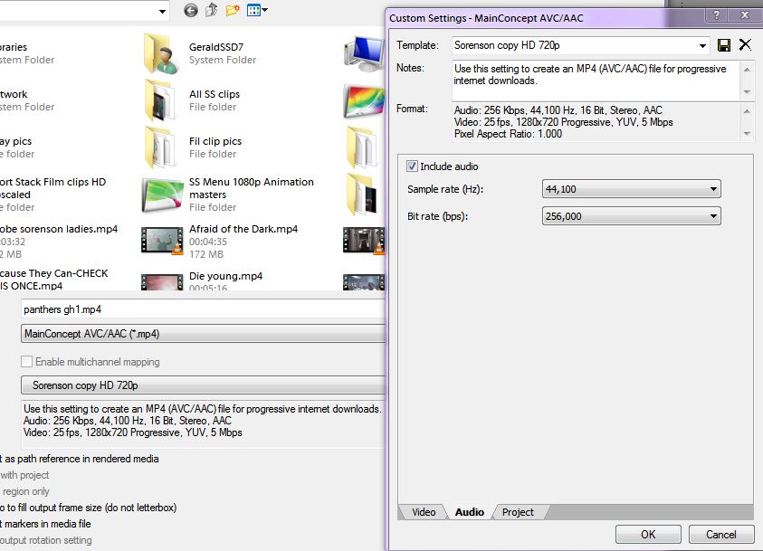

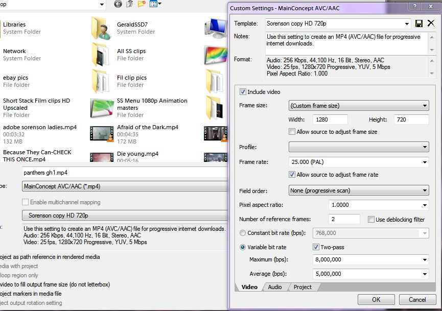

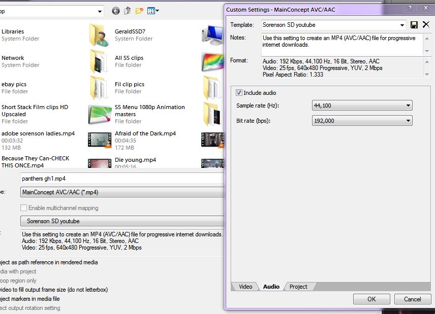

These profiles come from the Sorenson Squeeze profile exchange, even though there seems to be a lot more settings in Squeeze, I transferred as much info as I could and it still works with our limited Vegas render settings.
cheers people.
shooting for web - need help with AVCHD-hd-settings.jpg   shooting for web - need help with AVCHD-hd-audio.jpg
shooting for web - need help with AVCHD-sd.jpg   shooting for web - need help with AVCHD-sd-audio.jpg
