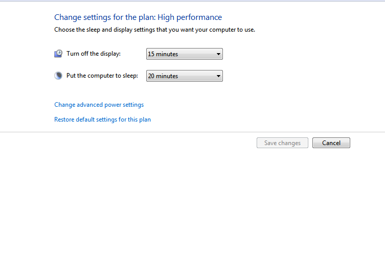

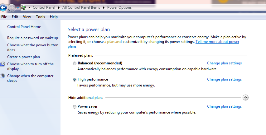

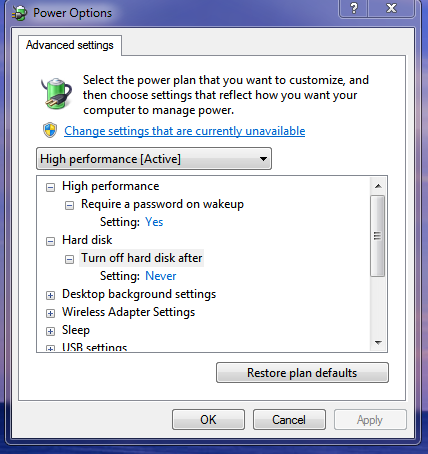

On any windows machine, regardless of processor these settings should be changed. I find it to be most important thing that I do when setting up a PC for editing.
In Windows 7:
1. Go to control panel > power options > select power plan.
2. Choose High Performance, than click on "Change Power Plan".
3. In following window click on Change Advanced Power Settings.
4. Scroll down to Hard disk and change setting to Never
5. Scroll down to USB settings and choose Disable.
When you don't do these things, when you are editing, Vegas will act hinky at times. USB drives get weird also.
Say you take a break from editing, and go back to work 20 minutes later. With the default Power Saving settings, the hard drives have all stopped. This will cause a "Vegas not Responding" episode because it cant' access the drives where the video files are located. After the drives have started spinning again then it's all good, but this can also cause a crash.
I mentioned this to Dave because I just reinstalled windows recently and forgot those settings, and Vegas behaved weird, especially when I saved projects to different drives. I changed those settings, and everything was perfect again.

Jeff??? I can't seem to find the "Never" setting on Win7 Pro?? Mine just allows me to change the minutes..however I set it for 150 minutes..there is no way I will be sitting staring at the screen for nearly 3 hours!!
Chris
Old November 1st, 2011, 08:31 AM   #15
Location: Cincinnati, OH
Posts: 8,425
Re: New Computer for Sony Vegas 10 - Quad core or Six Core
use the arrow button and take it down to 0 and it will change to never.
