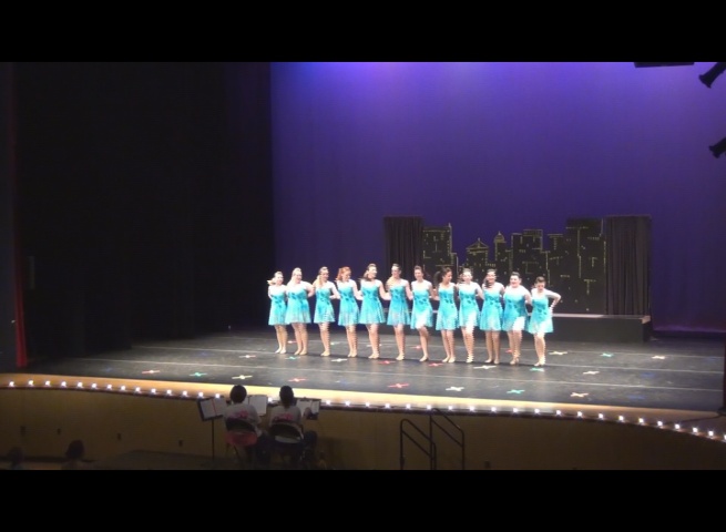

Old June 8th, 2011, 07:36 PM   #42
Location: Fredericksburg, VA
Posts: 282
Re: Amateur Recital Video Editing
Hey Brad,
Too litle too late for this project, but for future reference, I recommend immediately trying color curves to tweak such brightening/darkening circumstances in post. It allows seperate, simultaneous treatment of both the highlights and darks, preserving the one while you mess with the other, or allows you to mess with both at the same time.
I also prefer just a touch of sharpness usually. Even though I leave the slider at zero, I still find it mysteriously makes it better.
FWIW, I've also found that a video that I've shot too dark has way more discoverable information using color curves, compared to one that I've shot that was too bright with blown out highlights. The blown out highlights have zero recoverable info. Consequently, when post-editing is the intention, I prefer to err on the dark side when shooting a difficult scene.
Amateur Recital Video Editing-image1-orig.jpg   Amateur Recital Video Editing-image1-color-curve.jpg

Old June 9th, 2011, 08:42 AM   #43
Join Date: May 2011
Location: Warren, Ohio
Posts: 108
Sam... Thanks for the advice - looks pretty good! It may not be too late because the "bright" clips that I am using are only from my secondary camera angle which I am only using sparingly to cover mistakes with the main cam. I only have about 10 short cuts to this secondary cam on my timelines right now so it shouldn't take too much get them corrected if I can figure out exactly what you did.
Back to the rendering out of Vegas to an intermediate format to use in TMPGenc - I tried a Bluray preset under Mainconcept MPEG 2 and the file format was not recognized by TMPGenc (I think it was an AVC file extension). I am also trying to render as a Sony AVCHD (mt2s) format to use in TMPGenc, but the render for a 1 hour project took just over 8 hours (is this even a good format to use?). I'm really struggling here with what format to render out of Vegas for use in TMPGenc.

Old June 9th, 2011, 09:09 AM   #44
Posts: 282
Originally Posted by Brad Ridgeway View Post
Sam... Thanks for the advice - looks pretty good! It may not be too late because the "bright" clips that I am using are only from my secondary camera angle which I am only using sparingly to cover mistakes with the main cam. I only have about 10 short cuts to this secondary cam on my timelines right now so it shouldn't take too much get them corrected if I can figure out exactly what you did..
Check out the veg file I included in my post. Open up the effects applied to the clip on the timeline to see exactly what I did. Hopefully it's accessible there. Use the same clip you posted online as the source.
I'm assuming this will work for you ;-)
