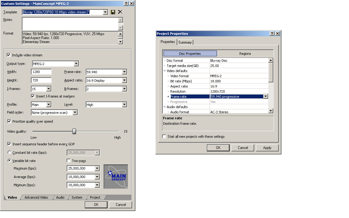

When you create the preset make sure that as well as setting 1280x720 59.94 you also make sure that the field order is also set to progressive and check all these before you render. I have found that although the project looks to be progressive 59.94 that is not enough without checking that the field order everywhere also says progressive. If not then DVDA will want to re-render.

I started from a Bluray 1920x1080 preset then changed parameters and saved a new preset as pictured below. The DVDA settings are also shown. Critical are the field order as well as frame rate and the bit rate MUST be below 28000. Hope you get it working you can change the parameters to match as this is just the base I used for the test. Setting ave will automatically set the min which could of course be less than the average !!!!
Ron

On the DVDA end, I had that for sure. I just discovered last night that in Vegas template the Level needs to be "High", not the default High 1440, which I did try, but that setting alone didn't alleviate problem.
Really appreciate the time you've taken, and for the screenshots especially.
I'll let you know what happens!
Old May 26th, 2011, 10:20 PM   #36
Location: Cincinnati, OH
Posts: 8,425
Re: DVDA wants to recompress HD video
Ron, just tried your setttings, and noticed your aspect ratio is set at 16:9 instead of square pixels...and wait....it works! I was using square pixel setting.
It is NOT wanting to recompress! Halleleujia!

Ron, you deserve an award for Samaritan of the year, or something. You stuck with this from beginning to end, alone, and for that I'm grateful. I am putting you in for a raise effective immediately. It should show up in your next check.
This was the last major hurdle (I hope) in the HD process, and it's a pretty good feeling.
Thanks Richard, yes it's a bit weird after days of this playing around.
Ron, I can't beleive the PAR was the issue. 720p is made up of square pixels (right?), so I wondier why this adjustment is necessary. Not that I'm complaining.
