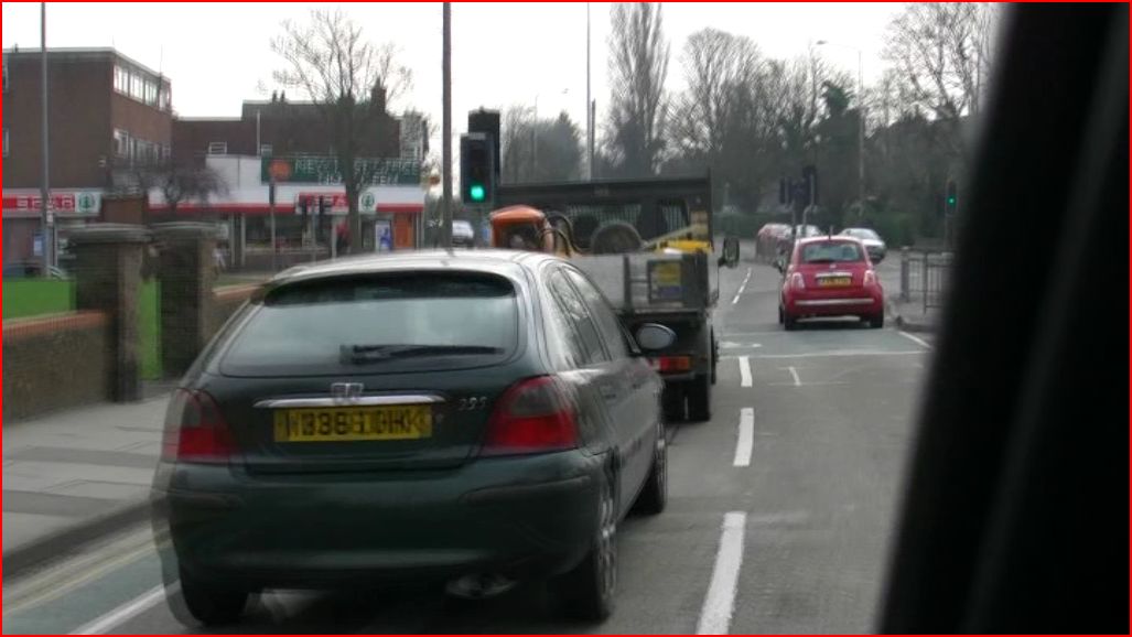

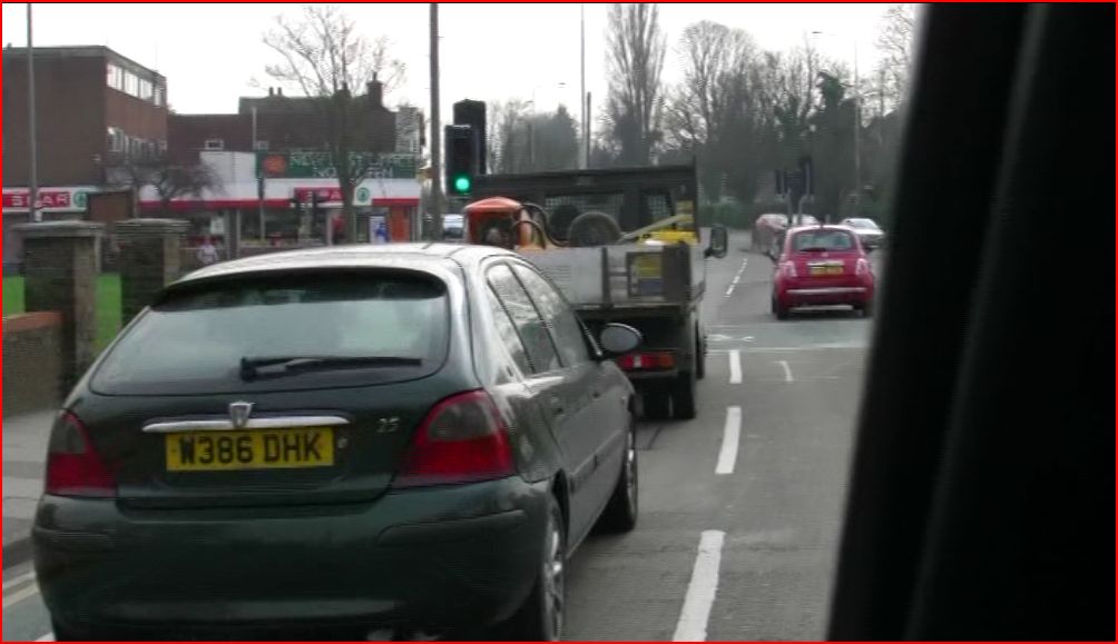

Hi Guys,
OP back, had some other stuff to do today and had to just stand back from this hd video nightmare and get my head clear as to where I'm going with the problem. Thanks Jeff for all your help, still not sure about Neoscene. Not going to comment on it at the moment, too early, but I will eventually.
And thanks Phill, that was a most interesting post about interlacing, I DID mention interlacing in post #15 and am sure this is where my problem lies. What is strange (to me) is that if I put an MTS file straight from the camera (which is 1080 50i PAL) into DVD Architect and let it render with default settings, I get
acceptable results. (smooth motion). I put the same file into Vegas and render using the Mainconcept MPEG2 CODEC and the DVD Architect PAL Widescreen video stream Template. (default settings). And when put into Architect and burn to DVD, It looks terrible. See attached! I have had a little success since I started this thread in as much as I now have vegas resizing properly and have tried the blend and interpolated settings and yes the interpolated setting is best but on burning the dvd, when played the motion is not fluid, looks almost strobe like, but no double image when put in freeze frame.
Phill would you care to share your settings or workflow etc.
Would appreciate it!
Regards
Richard
avchd (mts) to SD DVD via vegas pro 10-mts_architect.jpg   avchd (mts) to SD DVD via vegas pro 10-mts_vegas.jpg

Hello Phill,
Yes, went into project properties and set to best rendering. Set the interlace to interpolate. Set everything to upper, 25fps. Bit rate set to 8000 as I thought that was the highest possible for SD DVD.
Your setting for Architect was interesting, I notice the interlacing in Architect was/is set on Auto and recompress was/is set to Off, are you saying interlace should be on to force Architect to interlace and
should recompress be on again to force Architect to recompress.
Of course I will try these setting when I get back into it.

Hello Phill,
That worked perfectly, only thing is, I'm not sure what is different to how I'd set it before.
Apart from two settings and that was the average bit rate, which you put up to 9,000,000,
I had left that to the default 6,500,000? and the BEST setting in the project tab, I missed that one
completely. I'd sussed out the interlacing this afternoon, I'd got rid of the double image during pause,
but wasn't getting smooth motion, I guess it was the average bit rate increase which has cured it.
Doesn't play too well on the computer, as expected. But silky smooth on the DVD.
