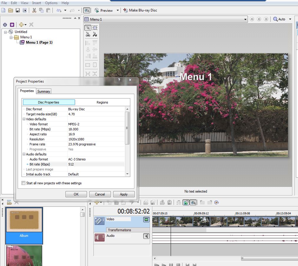

Regarding your comment that “a BD has a slightly different structure than an AVCHD disc” I can only respond with this:
It strongly depends upon what you classify as “an AVCHD disc“. If you mean the directory structure created on memory card (or any other media storage) by AVCHD video format, then yes, it’s slightly different from the BD specification.
First and foremost, in the AVCHD structure, names of directories and files comply with 8.3 DOS standard (no more than 8 characters for filename, no more than 3 characters for file extension), while Blu-ray standard uses long names for directories and files.
Then, AVCHD directory INDEX.BDM is named index.bdmv in BD; MOVIEOBJ.BDM corresponds to MovieObject.bdmv; all AVCHD files with extensions of MPL become *.mpls files in BD; the extensions of CPI change to *.clpi, MTS to m2ts. Also BACKUP directory does not exist in CERTIFICATE folder of AVCHD but does in BD.
However, in practical terms, a DVD-R disc with HD video (i.e. a Blu-ray project on DVD media), burned with, for example, the DVD Architect Pro 5, does not differ from analogous Blu-ray disc (the Blu-ray project on Blu-ray Disc).
So, to create such disc, you need just to select “Blu-ray Disc” as your project Disc format and 4.7 GB as the Target media size.
I’ve enclosed a screenshot of my own project in DVDA 5 to make the explanations more tangible.

Arkady has provided a much better explanation.
I have just made project from 15 mins of AVCHD from my NX5U, edited in Vegas and exported as Sony AVC at 18Mbps as well as an AC3 file from Vegas of this region. Started a DVDA project using the Bluray preset, AVC 1920x1080-60i 16x9 and AC3 as starting points. As with Arkady's view using properties changed disc size to 4.7, made sure video was AVC and audio AC3. Placed chapter markers and menu. Burned 4.7G disc. All plays fine on my PS3 and Sony Bluray players just like any other Bluray disc.
I only have DVD Pro 5.0 so cannot comment on DVDA Studio but would be very surprised if it was much different since the whole point is for consumers to burn their AVCHD discs edited from Sony AVCHD camcorders!!!!
Ron Evans
