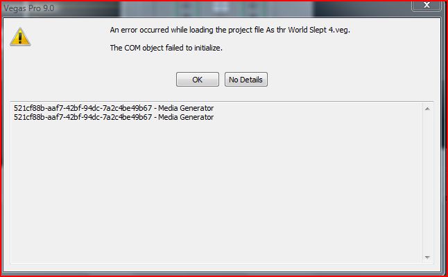

I have a project that I haven't worked on for a few months. When I attempt to load it, I'm getting the attached message. What does this mean?

It means that Vegas cannot find a component whose UUID is 521cf88b-aaf7-42bf-94dc-7a2c4be49b67. I have just searched the registry of my computer for that UUID and did not find it there, which tells me it does not belong to Vegas itself but most likely to a plug-in.
I have also searched the web for "521cf88b-aaf7-42bf-94dc-7a2c4be49b67" and found two message threads on other forums discussing the exact same problem. Both forums were in Russian so I did not understand every single word on them, but one mentioned Boris Red, and suggested to re-install it, but the re-install of Boris Red did not help him (well, you can see it for yourself if you understand Russian).
Oh, wait, this other thread states:
спасибо, переустановил борис и все норм
That means: "Thanks, re-installed Boris and everything is normal." So, there. Re-install Boris! Perhaps you last opened the veggie in the 32-bit Vegas and now tried to open it in the 64-bit Vegas? At any rate, as per the Russians, it is a Boris problem.

Thanks Adam; that was the problem. I had installed an evaluation copy of Boris Red on Pro 8 when I created the project that I couldn't open. I reinstalled the Boris Red eval and was able to then open the project. I exported the final of the project as a Cineform file and then uninstalled the Boris Red eval. That's something to keep in mind with evaluating plug-ins. If you uninstall them, you may wind up with a project that you can't subsequently open - not a nice surprise!
