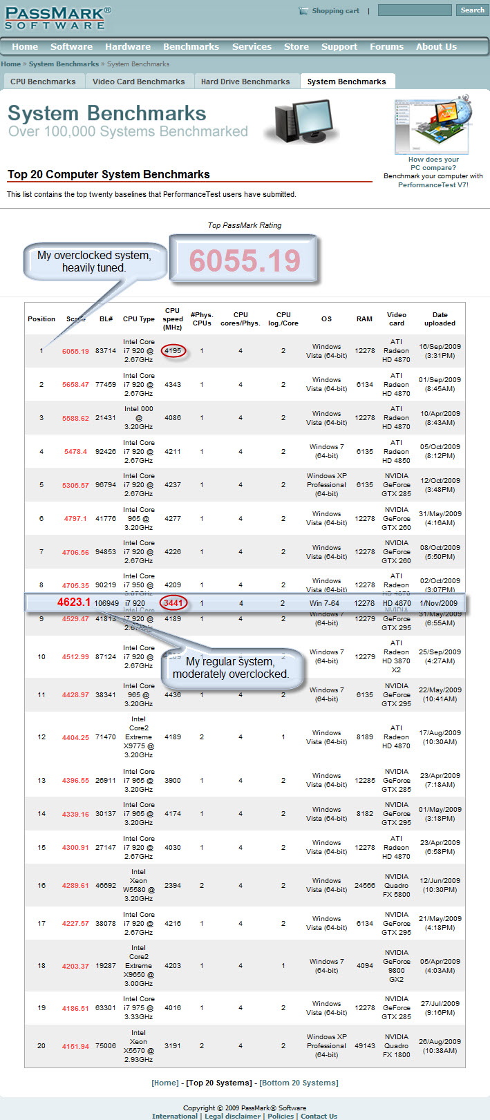

Old November 10th, 2009, 05:44 AM   #39
Posts: 1,832
Vito,
That sure looks like a great mobo and ready for the WD or Seagate 2 TB SATA3 disks.
Benchmark results for the i7-860 are still severly lacking and I have to admit I do not know of any benchmark test specifically for Vegas (there is one for Adobe CS4, PPBM4 home page) but as far as it may be helpful, here are my results with the i7-920 overclocked, which does not give me any reason to doubt the choice of the i7-920:
