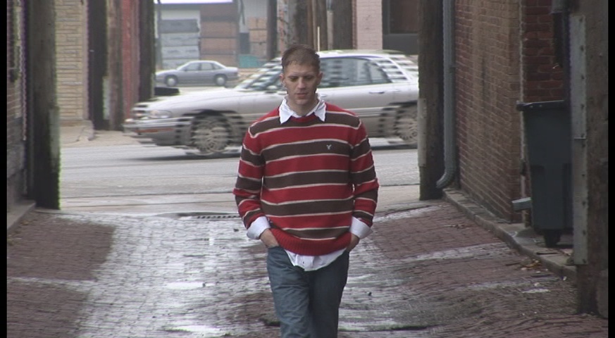

Old October 30th, 2006, 05:15 PM   #1200
Posts: 25
motion lines
I am working on a scene where the talent is walking up an alleyway. Behind him are cars going by pretty quickly. I am getting very pronounced lines across the cars. I am attaching a screen cap, so you can see what I mean. I Cineformed on capture and the original file does NOT have these lines.
What setting in Vegas am I missing?
