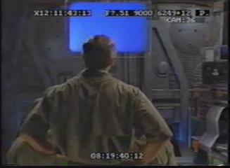

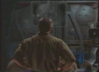

you might be able to get away with 2 ( 2 1/2) D tracking software ..
combustion might do it - it will track the 4 corners of your TV set and then set in the B roll and apply tracking info ( it will bend the corners ) ..
IMO vegas is not really set up for motion tracking ..
here's effect done on FLAME - keying/stabilize/tracking a clear plastic size sceen ( edges of screen are lit so you see edges) with blue screen material on it .. and then keyed with image that gives illusion you can see thru image to back wall..
Don Donatello is offline
