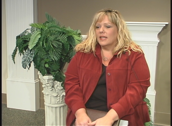

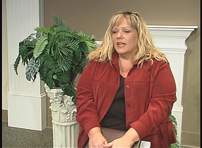

Color Correcting help
I need help color correcting!!! I am getting the VASST DVD on color correcting for Christmas(Gift from my son) so I can not get it until then. In the mean time, what would be the best way to correct the differnce in the color of the jacket this lady is wearing...any help is appreciated. Image0 is closest to real life
Vegas Video discussions from 2006 (Q3Q4)-image0.jpg   Vegas Video discussions from 2006 (Q3Q4)-image1.jpg

looks more like Exposure than color to my tired old eyes. I would pull a screen shot of A to the clipboard put the cursor over the area you want to fix then Split Screen the image. Use LEVELS FXs and adjust gamma first and see how that looks. You can always goto the Color Correction FX if necessary to highten up the color.
Don

Notice how much brighter the first one is. That means you need to set your white point more aggressively in the second one. Then you need to use secondary color correction to get the reds in line. In Photoshop I found the following settings worked well:
Levels: move highlight from 255 to 190
Hue/Saturation: shift red +15, making sure to deselect the skin.
You can do the same thing in Vegas....

The DVD explains this well, since it shows you the whole process including how to use the clipboard function. (It's the camera matching section/chapter.)
For a quick rundown, you can take a look at my .veg and look at the filter chains.
http://www.glennchan.info/Proofs/dvinfo/dgrimes.veg
Basically:
A- The unsharp mask on the wider camera tries to make the perceived sharpnesses match.
B- The exposure on the second camera was brought up. I prefer using the input start and input end over gamma, since gamma causes subtle changes in hue and saturation.
C- The secondary CC makes the coat color match. You can use another secondary CC on the wall too.
D- Color corrector to get white balance. (I was lazy here. It should be applied to both clips.)
Cheers.
