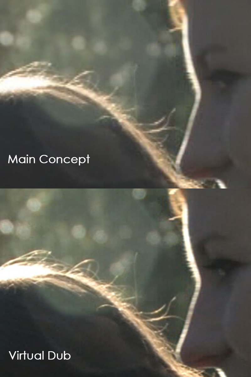

Following Perrone's basic workflow, I tried a bit of footage and am quite impressed with the results.
I rendered the same clean (no effects etc) 1440*1080i clip from Vegas using:
a) Main Concept DVD Architect PAL Widescreen Video Stream template
b) Cineform Neo Scene Codec at 1440*1080 (.avi)
Imported the Cineform file into Virtual Dub. Applied the resize filter (720*576 PAL) using the Lanczos3 filter mode - rendered back out of Virtual Dub using the same Cineform codec.
Imported both the Main Concept and Cineform/Virtual Dub files into a Vegas Pal Widescreen project and took these two frame grabs. I'm very impressed with the overall sharper image - and there is more detail.
Sweet!

Nothing like trying it for yourself and seeing the results in front of your own eyes. It's a pretty big difference. Considering that the Lanczos isn't necessarily the best at this, its remarkable how poor the downscaling is in the NLEs. And you used Cineform (twice), which is NOT lossless. I use lossless codecs which improve on the workflow you've used here. Not saying Cineform is bad, mind you.

I've always been impressed by the SD quality of commercial DVD movies and lamented my lack of ability to take a 1440*1080 image and somehow lose sharpness by reducing it in size - coming from a Photoshop background, this was an unsuspected dissappointment. I thought there was some possibly archane magic going on with how well feature length studio movies were squeezed onto a single DVD with such sharpness and detail. I'm glad I stumbled upon this thread. I must look into other methods i.e. Lancoz etc.
I hear you with the Cineform codec. I'll only use that on projects over 30 minutes. I'll definitely use lossless of one form or another to go between Vegas and Virtual Dub.
http://www.dmvideostuff.co.nz
