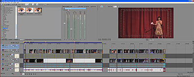

I got the same email and downloaded mine. I am beginning to install. I was surprised to see that it comes with DVD arch version 5.0b which I already had from my V8 upgrade but here goes...i'll be back after install.
I am back-installed and registered. It will take several weeks to give it a good test run but i am impressed with the options. If I already had NewBlue FX sampler, I would probably already have a lot of the new transitions and FX that came with that but for me this looks like a good investment at ~$185US.
