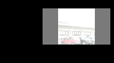

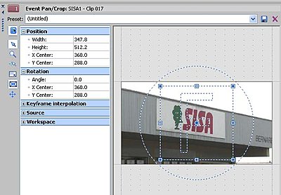

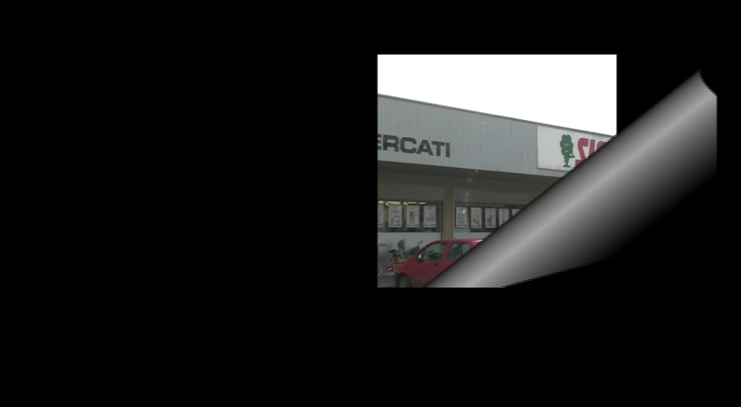

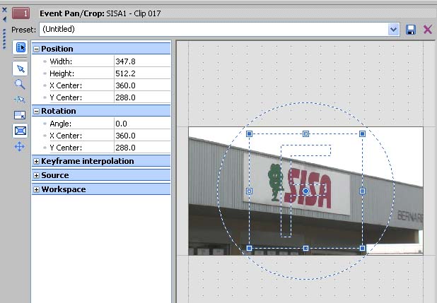

OK, in creating a sample to explain the situation I realise that the circumstance under which this problem occurs is when I change the aspect ratio in the pan/crop tool.
Attached are three stills, one that shows a page peel in progress and one that shows a flash transition at about the midway point. The third shows how I have cropped the original clip.
It's clear that the transition doesn't see that I have ignored the aspect ratio and cropped a widescreen image to look square. The transitions operate on the area that would have been occupied by the clip if I had maintained the original aspect ratio.
Hope that makes more sense of what I was trying to explain earlier.
You can see that the idea of using a mask above the clip would work fine for the flash transition but would not work so well on the page peel (or similar). Not that I am a fan of page peels, just using that example to illustrate the point!
