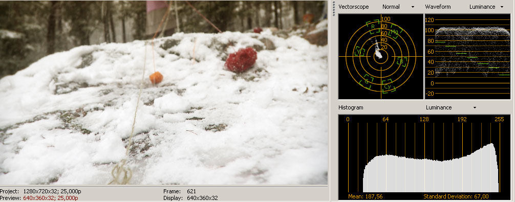

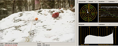

I'm looking for practical advice for a problem I have.
On Vegas preview window everything looks good (see image Before-render.jpg) and after I render it to mp4 file via Mainconcept templates it comes out with highlights crushed (after-render.jpg). Can you help me achieve the look that I see in my preview window (Before-render.jpg)?
I havent messed with any RGB conversions. Only done a lot of color correction with color curves in Vegas 8. Original files are MXF files from EX1 camera.
Thank you!
Sami

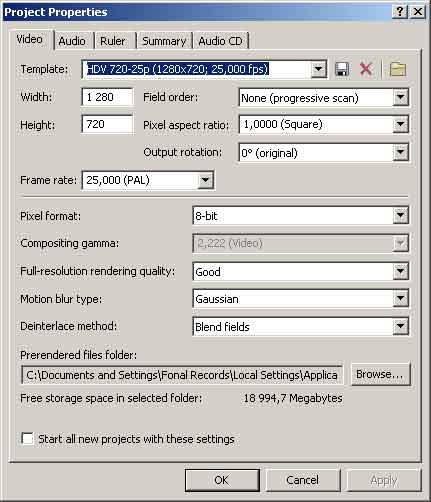

We need one more bit of critical info.
Can you paste a screenshot of your project properties window? The one you get when you click File -> Properties.
Here you go. Thanks!
Yep, that's what I figured. You are working in an 8-bit project.
So your preview window is showing computer RGB. The full 0-255 colors. When you render to a format that is destined for broadcast, the values get clipped to what broadcast can show. On Glenn's chart that is Studio RGB or values from 16-235. A subset of the Computer RGB signals.
If you were working in Vegas with Studio RGB then you could output to any codec without the clipping. It's an ugly PITA problem. And one reason I stick to working in 32 bit mode.
