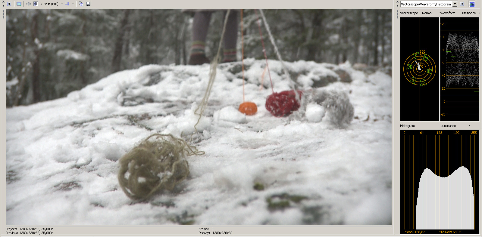

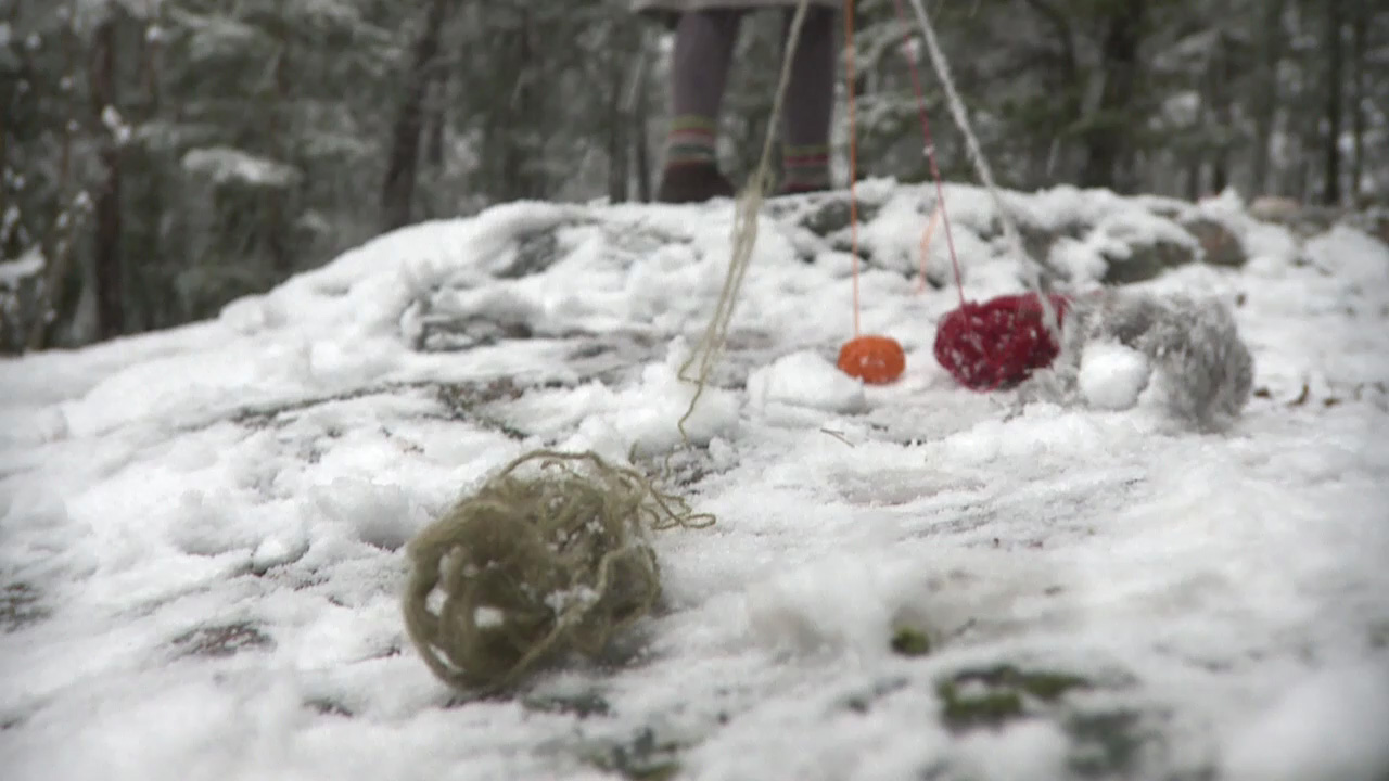

Here are some pics from mainconcept mp4's renders.
1. Vegas timeline (8bit project, no FX)
2. no FX render (Whites clip very hard)
3. Glenn suggested levels (Whites are slightly whiter and blacks slightly blacker than on the timeline)
4. Computer to Studio RGB with levels FX added (Looks exactly the same as on the Vegas timeline)
Jpegs are done by opening mp4's in photoshop and saving as jpegs. Vegas timeline is a screen crab.
Please take a look at the pics and tell me your opinion. I think this is a very interesting topic and Im very close to understanding the procedure and hopefully making amazing videos that look the way I want :)
Again thank you for all your help!
Sami
PS. If anyone wants I can provide this EX1 MXF file for testing.

Old April 6th, 2008, 08:32 AM   #41
Location: Haiku, HI
Posts: 203
Images: 12
Hi Sami,
My guess is that the confusion is being caused by the way Vegas opens your clips in 8 bit by default. That is what confused me, as this is not the way the clip actually "is". You may notice that Clip browser displays your clip much diffferently than Vegas 8 bit (exactly like your Mainconcept render of 8 bit). So does Sony Clip Viewer on a larger scale. To make Vegas match clip viewer or clip browser (or Edius by default) you have to either convert from studio RGB to Computer RGB or open in 32 bit. Working with the default does not give an accurate represntaion of the original file.
Randy Strome is offline   Reply With Quote
