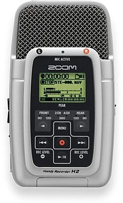

Iriver's was maybe the best choice out there for various reasons. For me Size and quality. I have the Ifp999 1Gb it cost around $300.00 at the time. I purchased it like 2 years ago. Now the Irivers are not the same no Line/Mic inputs. All you can find are used or refurbished units.
But there is a new kid in town. I preordered 2 Zoom H2, which hopefully will be using instead of MD. They should be out by May and so far looks like a perfect solution, and can be used with the integrated 3 side mics, take a look at the attachment. More info here:
http://www.samsontech.com/products/p...1916&brandID=4
Alexis Vazquez is offline   Reply With Quote
