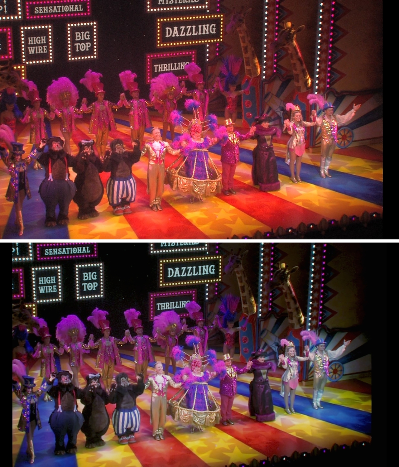

Re: How do you white balance dance recitals / stage shows?
That's a very good 'repair' video - and it did a rather nice job in recreating detail that was just missing.
It's still strange to be having to do this when clearly the post industry have some great tools, but surely it's unreasonable to buy cameras that are so bad at capturing images in anything other than one chosen colour temp, and worst, being unable to cope with things like the light sources that areb monochromatic - the flu's, the discharges and of course most LEDs. Chris shows the amount of effort required, but we have had LED stage lighting for a long time now, and little attempt has been made for cameras to shoot it. We really do have this weird opinion that the work a lighting person puts in should be totally removed for video? One of my shows last year did over 90% capacity on a long run, and it's crazy to compromise that because Mr Sony or whoever cannot build a camera that can cope! The people who watched it live got the amazing look, and video is secondary - and in my case, it's not even publically available. Indeed, some lightuing designers do not get re-engaged if their lighting is not 'wow' enough. Their career made by how the audiences see it. A request for white light was never appreciated, and now contractually, their 'product' is protected. The audience legally will never see a white light version. Video folk have to accept this. Unless the producers write video into a contract, it cannot happen. Looking back at this year's theatre shows, we do not have ANY tungsten sources any longer. So with many fixtures offering red, green, blue, white, amber and UV, the white option probably will not even be programmed. The person sitting in front of the desk may not have even got the white options showing in the pallettes. Whenever you do have a white light for some purpose, it's often white and blue to make it very stark, by contrast to the usual pinks and blues.

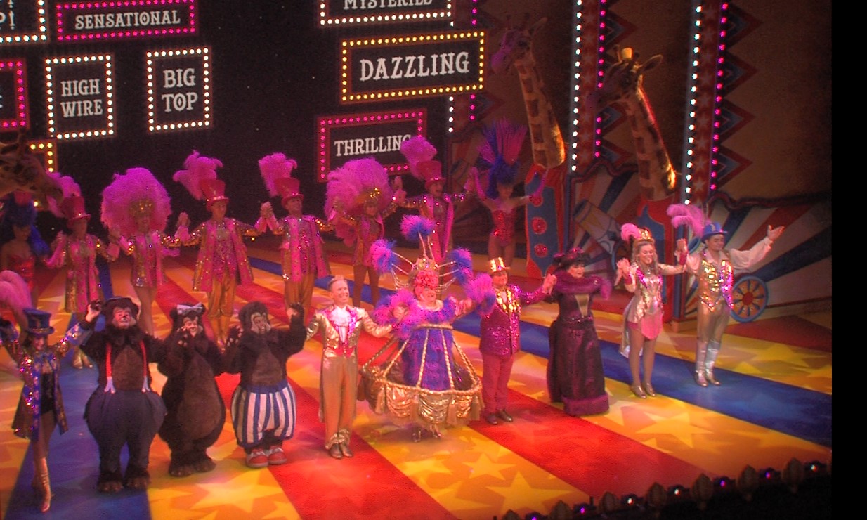

A typical dance show day would start run throughs at maybe 8.30am, and the lighting designer would be creating the lighting for each number. Around lunchtime, they might start an out of sequence dress rehearsal in costumes and the lighting gets changed, often radically to cope with the mass of green costumes, which had been lit in blue or red, meaning the green was black. There would be no need to turn the white knob. It does nothing to enhance what we see - so they'll have a colour pallette with all sorts of variations of colours. Then, as happened two weeks ago, the video people rolled up half an hour before the house opened and by the time they were set up, the audience are coming in. Then they ask for a sound feed. Tjhe audio guy had anticpated it and handed over two cables and said he couldn't send them show level because people were in, so expect a lot more than what they were getting. I noted two different brands of camera, so they will struggle with matching the colour balance. They did NOT ask for lighting changes, probably because they knew they would NOT get them. We offered a cable for a video feed = composite or SDI. They only had HDMI on the nearest camera and that was further than our longest HDMI cable - so 'we tried' was the best we could do.
In the whole show, there was not one scene that had any for of white static light - so I suppose a good place to be would be in a preset in the 4-5K range, and have that on all cameras as a best guess.
I've attached a picture - a still from the video. There is not a single light that is white - none! All those colours are a good aproximation of what they looked like. Variations in pink, magenta and the blues are visible. My Pentax DSLR cannot differentiate these hardly at all.
How do you white balance dance recitals / stage shows?-goldi.jpg

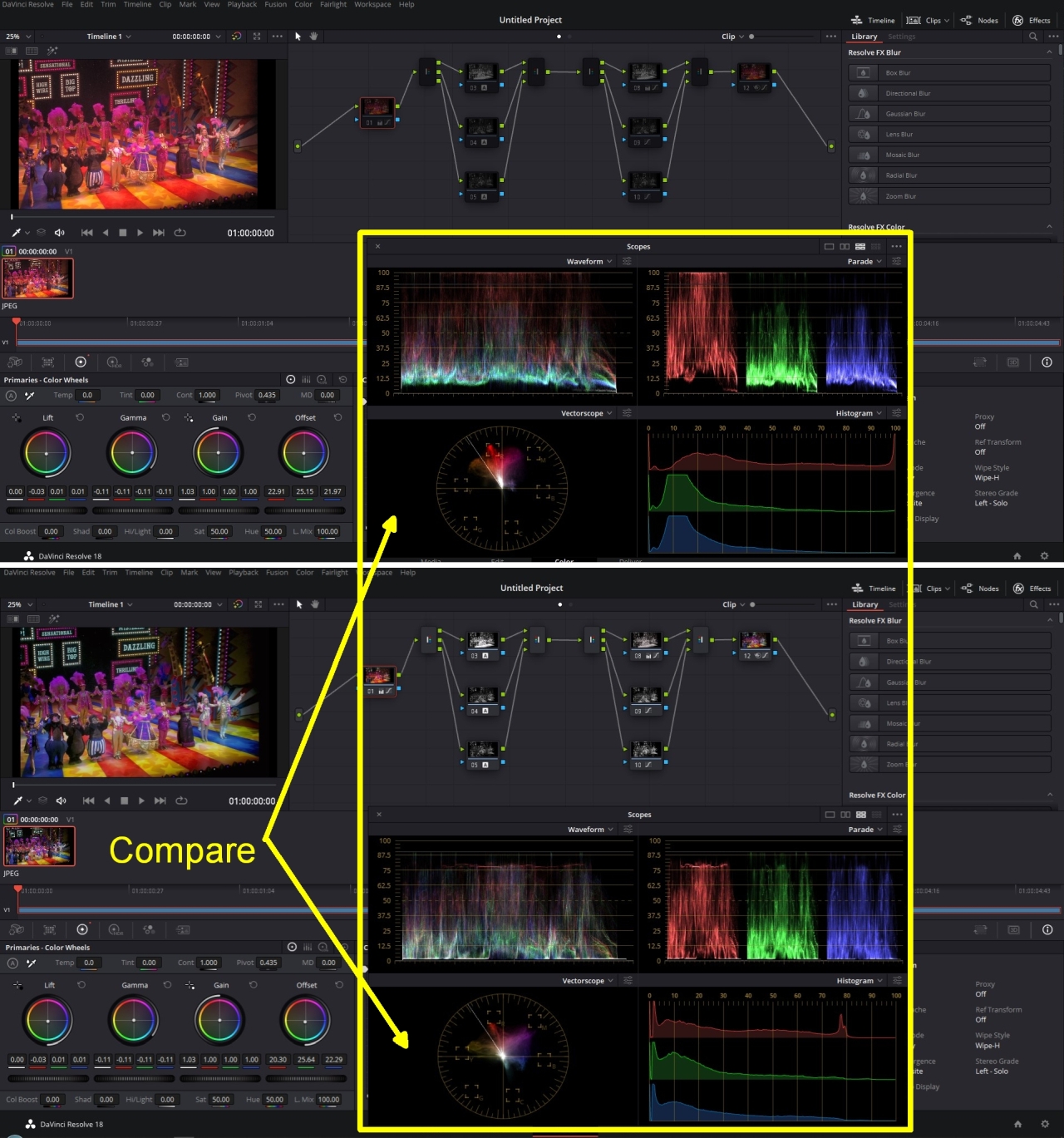

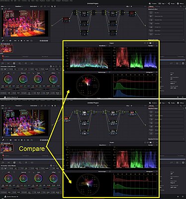

Paul. Very hard working off a JPG as they fall apart as soon as you touch them. All the same, It's a quiet Saturday here and the weather has been c**p, so I thought I have a play with your pix.
As you can see from the scopes, parades, vectors etc that the lighting has thrown everything out of whack. Even out of camera, a 709 image can be corrected for white balance quite easily. Here I use two splitter combiner nodes with a standard node either end. This took about a minute. This is what I do for each song in these sorts of scenarios. I create a Gallery still, which when applied to a clip opens up the nodes for fine-tuning if necessary. Not saying the sample is perfect by any means, but it gives you an idea of what can be done.
Chris Young
How do you white balance dance recitals / stage shows?-corrected-compare-1280-.jpg   How do you white balance dance recitals / stage shows?-cc-compare-settings-gui-txt-1280-.jpg

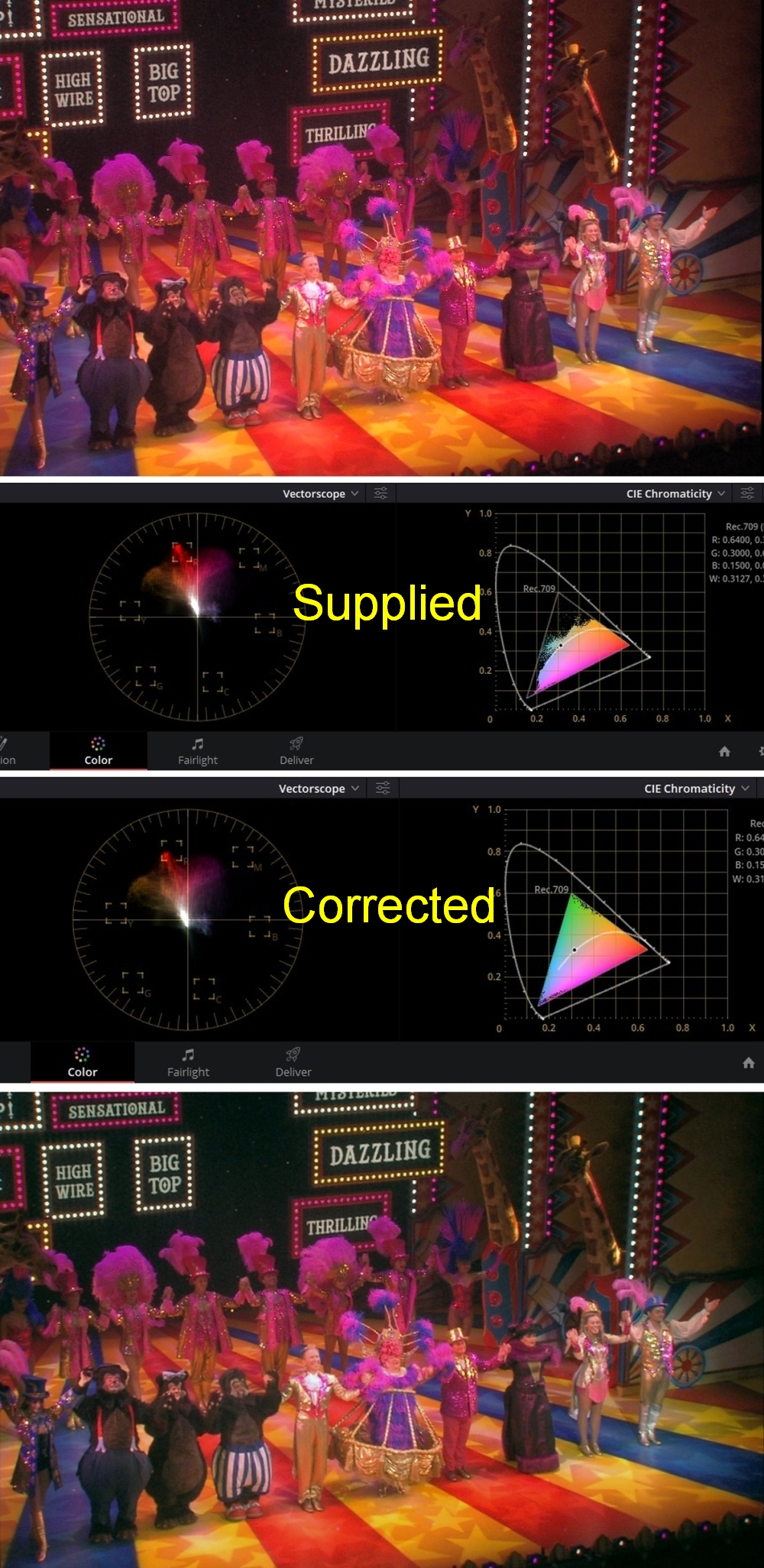

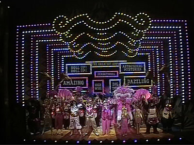

No - this is exactly what I mean. The image you have created is not real. If the lighting designer lit it to look like the perfect video image, they'd be out of the job! This is exactly the problem. The audience did not see a stage with the colours in the processed video. The Director spent hours with the lighting designer getting the 'picture' just right. Oddly, we take pictures of the sets in white light - not the stage lit version, because that will be different every outing. The same set can look totally different when lit by a different LD.
I attached the same show, mostly same costumes, different venue to make the point. In this example, I have no idea if the colours the camera recorded are real, as I did not take the shot. The one I posted is as far as I can get, the same colour as it really was.
I'm very interested in what the software can do - but in this case, the result is not in any shape or form, what was created - it's a reimagining. It never looked like that in real life. White balance is pointless when white did not exist in the original. For this kind of show, maybe pink/magenta balancing would be better - but theatrically, white is a seldom used colour. In plays or meetings, or stage use that's being televised like maybe a politician delivering a speech - then it will be white. It's not supposed to be pretty, so then real white, and correction as in your example, is excellent and quite correct. It's just inappropriate for entertainment. It's been a long time now since white light sources were all over the stage, they've always been tints - blues, pinks, ambers. Oddly - I do get the occasional request for face light for some entertainment shows, and if we are short on gear, we will rig some Source 4's over the audience, in open white. Followspots are the other white source, and these do need balancing, but usually that shifts magenta to a purply-pink, and makes blue look a bit odd, but a pink or blue tinged face looks bad in this context. Luckily, for musicals, face lighting will usually be tints again, so in that case, pink is correct - and correcting it, wrong.
I did have to jump in once in a production meeting when a Lighting Designer was being judged based on a show video and I had to point out that in the theatre, it was extremely likely the colours were much more vibrant and punchy and not the kind in the still I attached here. We have learned to never judge the lighting by photos, unless the person who took them understood theatre. My role is not really to take video and photos, but it got added to my job when my results met Directors approval and a hired in video team didn't;t get it at all. When you take 1.5 million at the box office, you want pictures that look like what people see. We now have many photographers who take pictures all over the country who do understand the importance of pink!
Is the floor yellow or orange against the red? In white light it IS yellow, but not when the light landing on it is pinks and magentas.
How do you white balance dance recitals / stage shows?-alt-goldi.jpg

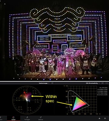

I think we are at cross purposes here Paul. Maybe I didn't explain myself too well.
Whilst I agree with your comments as to what the lighting and artistic teams have developed, that's for the sitting audience's benefit. As it should be. I've TD'd enough live entertainment shows for TV, well over a hundred over the last twenty-five years and there is no way those out of gamut color levels and saturation would ever make it on a live production. They have to be constrained to broadcast SMPTE 709 color and luminance levels.
Forgetting TV delivery. If producing for post delivery this still applies, whether it be DVD, BD or USB sticks for PC playback, none of those environments can correctly handle out of gamut levels. Including 95% of software players as they are looking for 709 VIDEO levels. Some software players do have 8-bit 10-bit full swing 16-135/64-940 selection settings, but not many. If you encode those out of gamut high chroma levels, they will absolutely be distorted on playback. That's like recording audio well into the red and expecting it to sound good.
What I was attempting to demonstrate is first come back to a neutral, corrected balance. Now if you want to introduce a bias, color correct towards, red, blue, purple or whatever color you choose you do that within the constraints of the 709 video CIE Chromaticity triangle. One should aim to get close to filling that triangle if you want good-looking results. If any of your colors go outside they won't meet any of the above delivery methods I've outlined, and you end up with horrible looking distorted colors and levels on any viewing platform. As you can see from the accompanying pix, the image you supplied has lost 50% of its information, mostly, and what's left is crushed into the red side. There is virtually no Cyan or Green channel there. It's been swamped by the overload in the Red channel. It's there, it just needs to be recovered. In recovering it within the 709 specs the colors whilst different to the image you supplied look reasonably close but more importantly are 100% legal for delivery via TV. DVD, BD, Web or software player.
BTW, all these should be looked at on a true 709 monitor or a quality TV to get some kind of subjective idea. But there again I see so many people editing video on PC monitors in Adobe RGB or sRGB space, so I have no idea how they end up judging the veracity of their images.
Unfortunately, in the production world we have to stick to the defined standards if we want our material to look good on any delivery medium. Not trying to teach grandma to suck eggs but if anyone really wants to understand the process of editing for delivery, broadcast, web, PC or optical medium and feels they are a bit at sea with it, it may be of interest to have a look here for a primer.
Chris Young
https://www.thepostprocess.com/2019/...full-vs-video/
How do you white balance dance recitals / stage shows?-cie-2-shot-comp-1000-.jpg

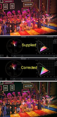

Your last sentence exactly. Whatever the color, if you don't want it distorted, it must meet 709 spec for all delivery mediums bar HDR deliverables. But then that's a totally different kettle of fish. Whatever the colors are or were, the colors in this shot fall within spec. The luminance levels of those colors were a bit over, but easily corrected. See CIE Chromaticity pix.
Chris Young
How do you white balance dance recitals / stage shows?-alt-goldi-cie-comp-txt.jpg

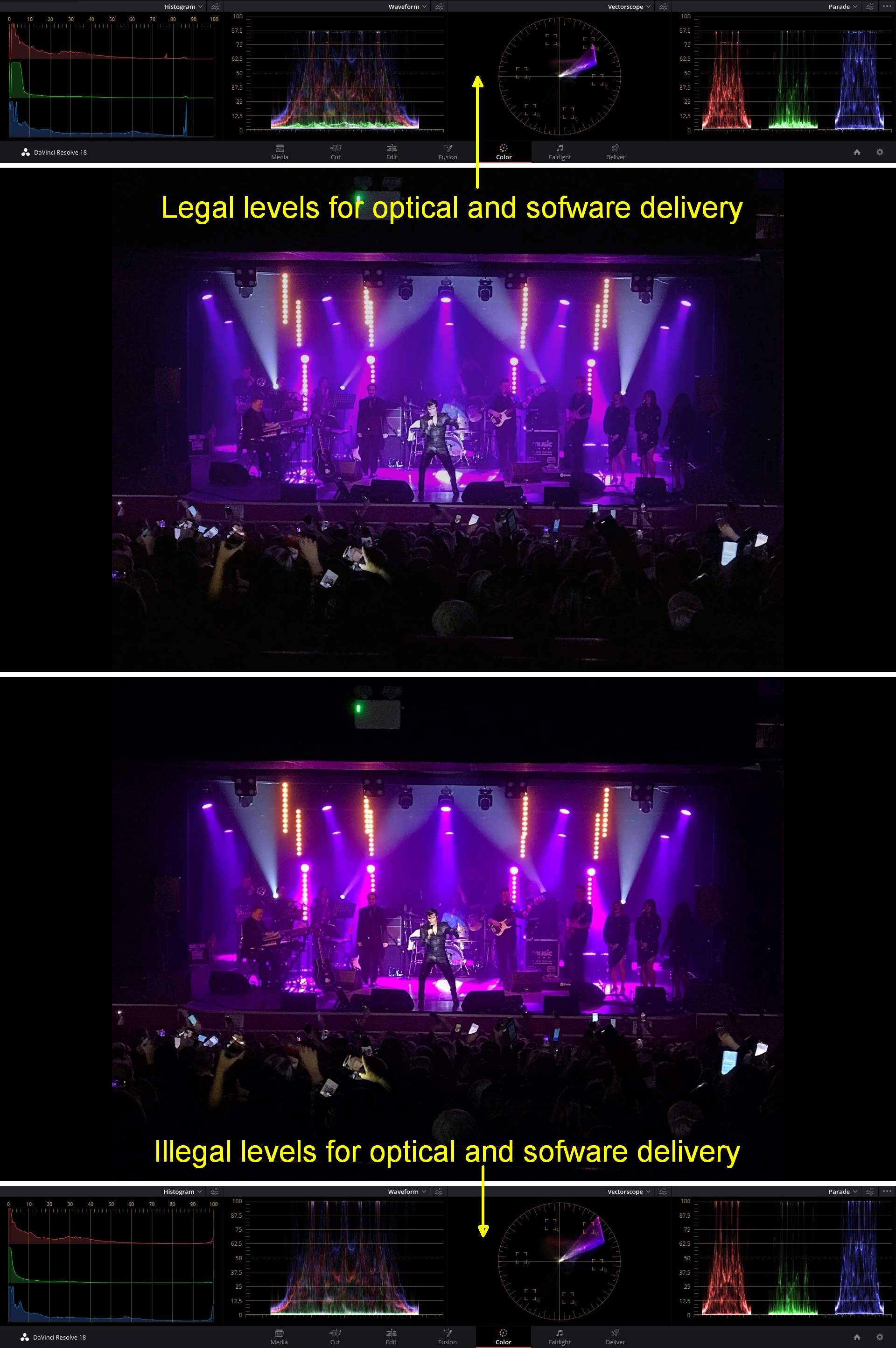

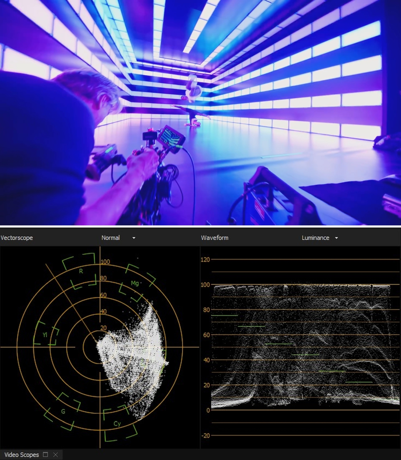

In no way do I see it as a "repair" when sticking to a standard. As most decent stage lighting outfits will. All the big rock concerts with fantastic, great lighting design and effects abide by these broadcast standards. And in no way does the visual experience suffer for those at the concert or those watching at home or later on a DVD or BD.
I TD'ed A Guns N' Roses concert video OB with awesome lighting design some years back and believe me we couldn't put a show like that to air with non-legal levels. The TV links and transmitters cannot handle it. Have a look at what serious lighting designers do. The biggest problem I find with a lot of stage lighting people is they have never been taught to light for video, only a sitting audience. In cases like this, we tell clients, when booked to do their video coverage that if they want top quality lighting for both the sitting venue audience AND video coverage, for broadcast, or for sell through media, they should book a good qualified lighting designer who knows how to light for both stage and video at the same time. They do exist.
I explain to the client, why are you going to all this cost on the production only to jeopardize your sell through media revenue by having lighting that is going to cause issues for the video side of your productions. One large theatrical company we contracted to for nine years, shooting between fifty and sixty-five concerts a year in the largest stadiums across Australia had disc sales in the order of 5-7000 per concert. They discovered if they had decent lighting design that the video post-production costs went down. As far less time was spent on trying to beat the shows into shape for broadcast and sell through media. Out of all the shows, a number of two-hour specials events were made for TV from all the competing regional events. So costs were important.

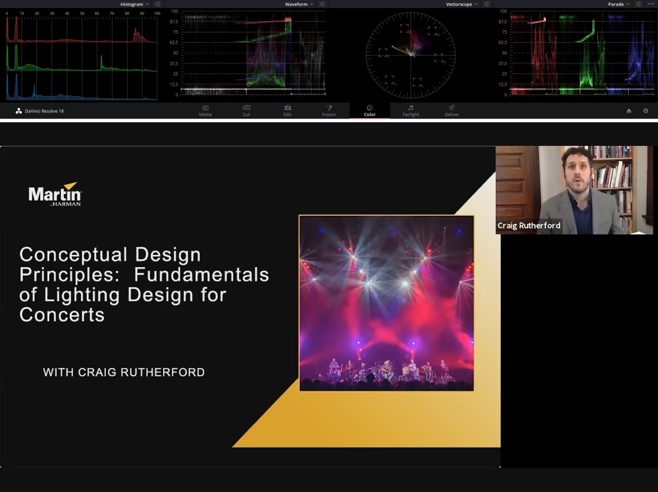

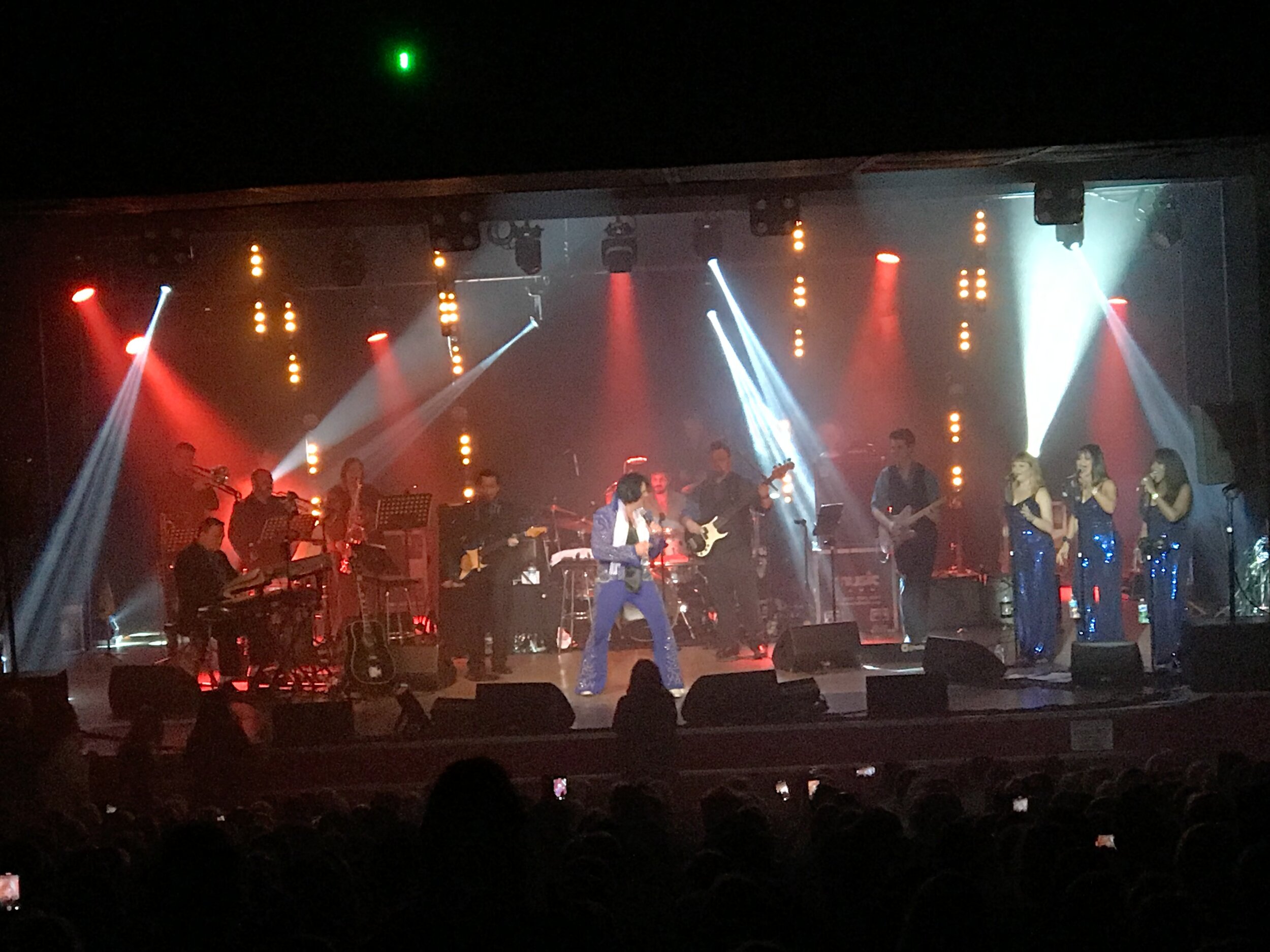

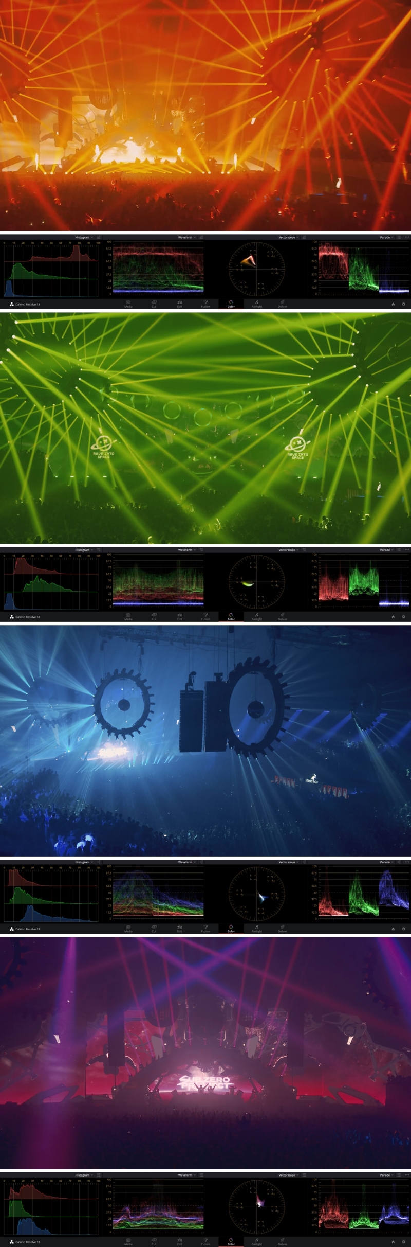

For illustration’s sake, I've grabbed a still frame from a lighting training video, which has some examples in it of stage concert lighting design. I threw this onto a Resolve timeline and what did I find. What I expected. Legal levels for video, even in their training videos. And yet great lighting design and effects for concerts. And I mean big concerts. They are Martin<dot>com. Also below is a link to a good lighting BTS from ARRI showing how you can use the wildest outrageous colors and deliver awesome lighting design and effect but still remain within the accepted standards.
Also, I had a tweak on the Elvis pix. Whilst keeping a similar feel to the lighting design, it can easily be brought into legal shape. This what we have to do when we are confronted with out of gamut stage lighting for video productions. See sample pix.
Chris Young
https://www.martin.com/en-US/markets/entertainment
How do you white balance dance recitals / stage shows?-elvis-cc-comp-txt.jpg   How do you white balance dance recitals / stage shows?-stage-lighting-levels.jpg
How do you white balance dance recitals / stage shows?-martin-dot-com.jpg   How do you white balance dance recitals / stage shows?-arri-lighting-scopes-comp.jpg

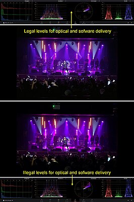

Until we reach the point where cameras can process light, its range and color like the Mark 1 human eyeball, the best optical device so far, photographers will struggle with photo stacking and us videographers will struggle with cameras where the current technology cannot cope with the lighting ranges we encounter whether it's daylight or artificial light or a combination of both. Hence, the development of LOG and RAW recording to be able to capture greater range.

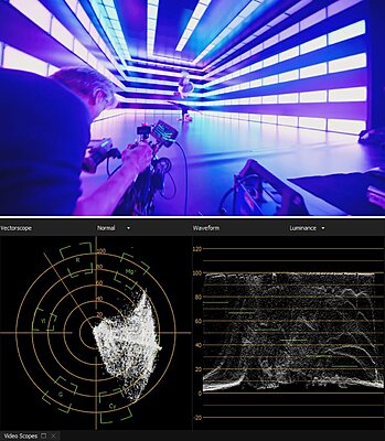

This massive light show, link below, was not at all impacted at all visually for the attendees, or those watching the live stream on TVs or PCs by having to work within legal levels. Really there is no excuse not to do so. Just saves so much time, money and drama. And in the long run with the added bonus of no colors looking horrendous to assault your eyes. Look at the level grabs below.
My last words, as I'm becoming far too boring. I guess what I'm trying to say is that sadly though, whatever we capture with, using LOG, RAW or the humble old 709 encode we have to massage it into the existing standards if we want it to look as good as it can get.
Chris Young
How do you white balance dance recitals / stage shows?-light-levels-comp-800p.jpg
