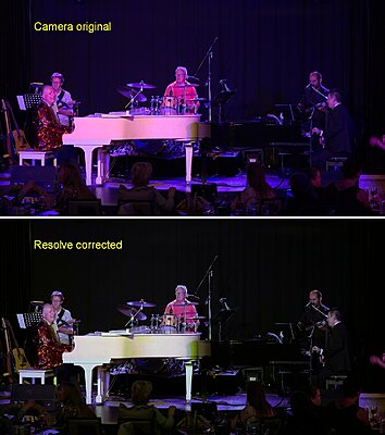

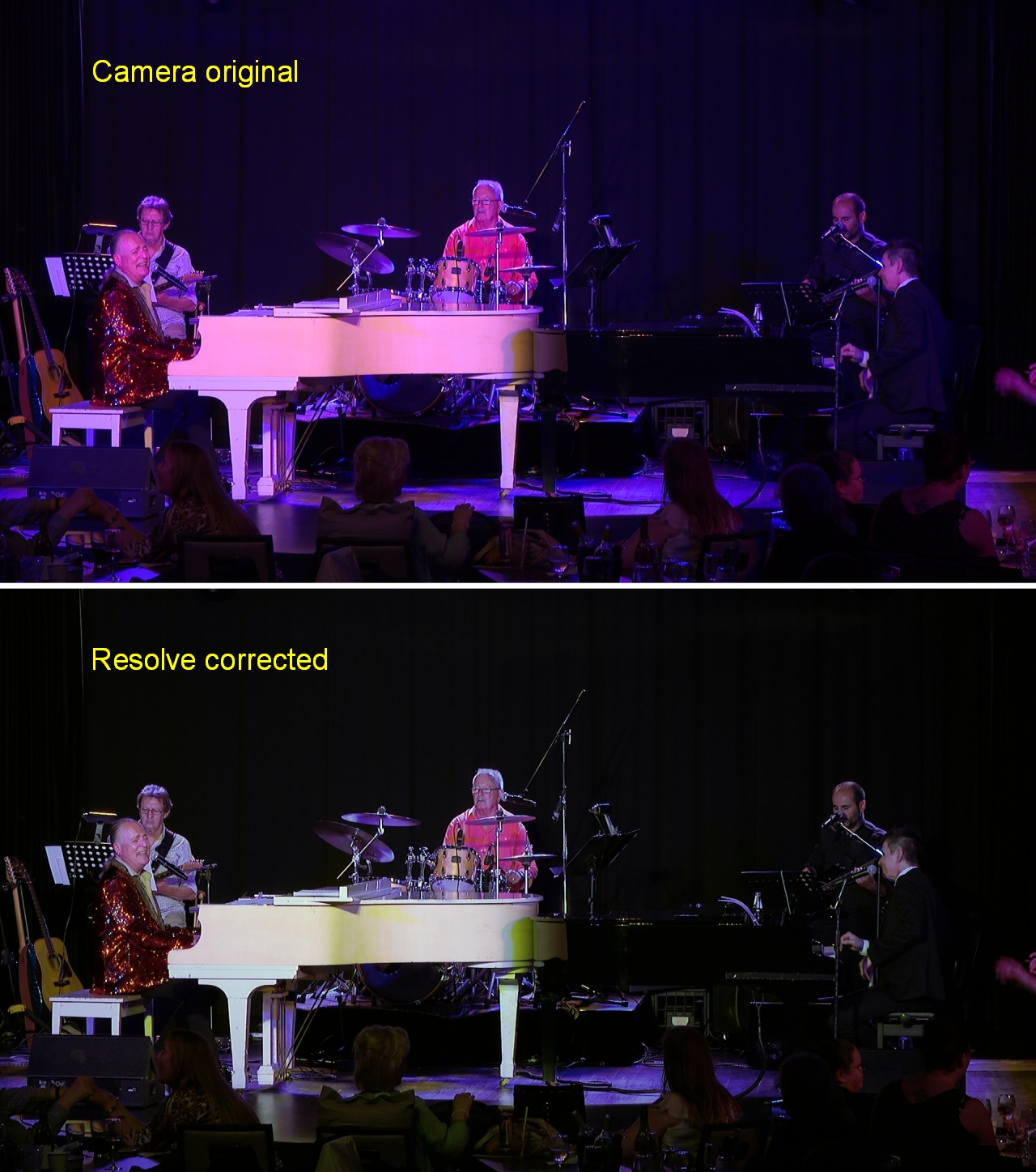

Re: How do you white balance dance recitals / stage shows?
Yes, still doing it. Though every now and again I still get a venue where they will not throw in a white wash, in which case I'm stuck with those horrible over saturated blues, purples, reds etc. If you have cameras with full SMPTE matrix adjustments then you can dial down the over-saturated colors in the Sub-Matrix, that can be a big help. If you don't have that luxury, what I do is go for a preset 4400K balance on each camera and then correct as best I can in post. As per a recent shoot. Sample pix below. If the cameras are the same, once I've got a happy balance, I can then apply that CC to the other cameras. The technique I use to correct is shown in the following YT clip.
