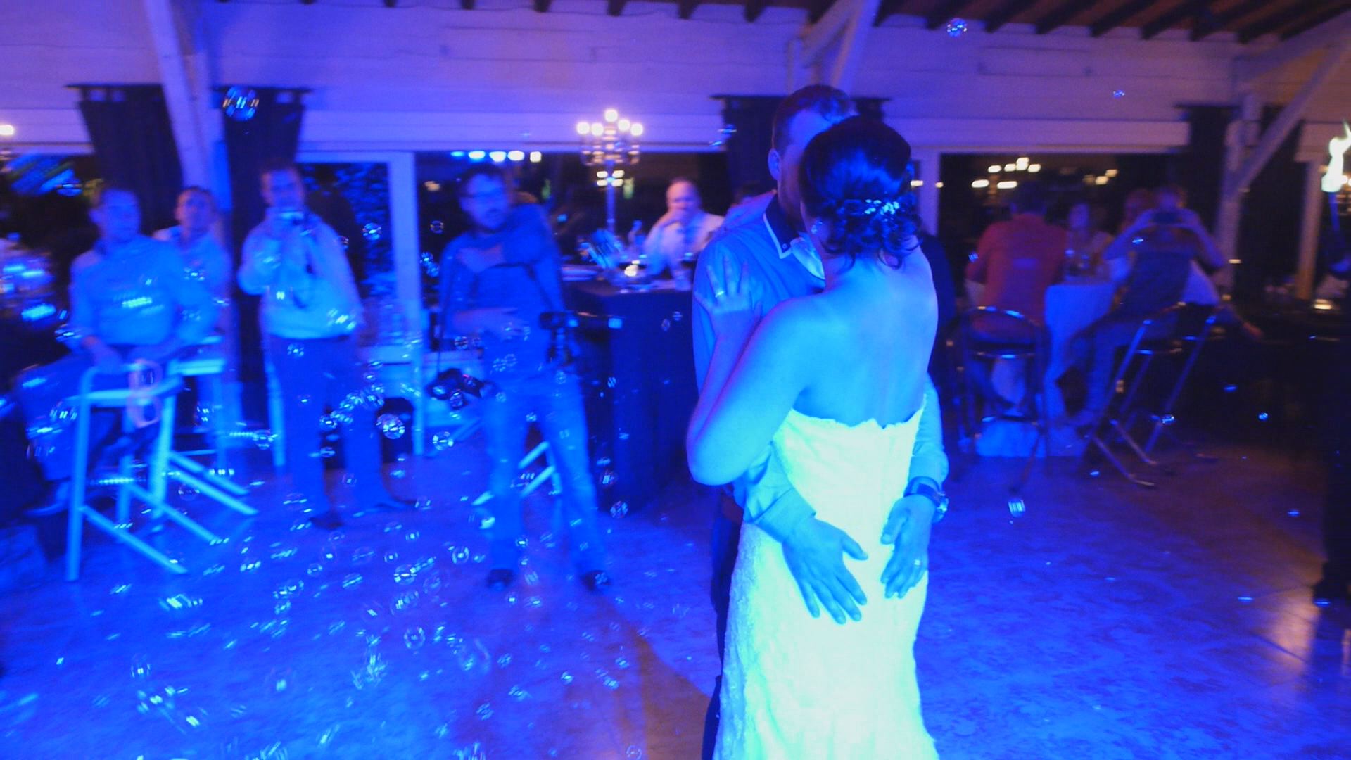

If have seen these harsh blue lights appear in many weddings I did this year, often not as an effect but as a constant light, I"m not planning to get a a7s but I did see a guy offering his almost brandnew grey import a7s for a very interesting price but it only sparkled my interest for a short time as I still would have to invest in a good, but expensive stabilised zoomlens as well. It was only after seeing those blue clipping highlight samples I wondered if it was a user error. Right now I"m editing some footage shot with a nex-ea50 in a venue that also had these blue lights pointed towards the wall and I also see highlight clipping but nowhere near as worse as I saw on some a7s samples. If you would need to have a backup camera ready to you'd lose the lowlight advantage if your other camera is not as good low light performer. Here's a framegrab from some footage shot with my gh3 with the dancefloor flooded with blue light and I had to deal a lot with this this year, judging from the a7s samples I have seen so far this shot would be impossible to make with that camera? Unless you raised the whitebalance to 5000+?

I've had to deal with some truly horrible DJ LED lights in recent months - they emit multiple focussed beams of light that blow out wherever they hit, surrounding the blowout you get a fringe of whatever the colour the LED is. Blue tends so be worse than others, you could of course expose for these highlights but it's pretty intense and would render the rest of the scene pretty underexposed. I consider exposing properly for DJ lights my biggest challenge at the moment.
Both my EA50 and A7s struggle with these lights unfortunately. I would not change my A7s however as the benefits of awesome low light performance and focusing aids make it a 5D3 beater IMO.

I do find that weird because the complaints I have seen so far in regard to the blue-light clipping is that it results in unusable footage and since those lights are seen at a lot of weddings I do wonder how they bypass that or maybe just not want complain about it.

A7s user here. Hands down best camera you could possibly own for receptions. Blue highlight clipping is user error. . It's just that, clipping. Expose correctly and there won't be this issue.

James, do you have any screen shots you could post where a blue light was shining brightly in the scene but did not get blown out? A friend of mine shot some footage for me and everything looked normal until the blue lights from the DJ started shining on people's faces. Immediately they all looked very blown out (albeit it looked kind of cool because they were dancing to electronic music) but for something like a first dance the look would not be as acceptable. My friend is a very good shooter and all the rest of the footage was exposed properly, so I'm just wondering if maybe this is an issue that occurs in some A7S cameras but not others. Let me know what you think.

But if you shoot at a dark reception, what would the point be of having a a7s if you need to underexpose to get rid of blue highlight clipping? I read so many conflicting info from people shooting weddings with it saying they get unusable footage with blu-light and some other saying it's a matter of choosing the right picture profile up some saying it's just a exposure issue, like below image I found, how would underexposing help here?

Blue light clipping is real and not user error, but there is a fix for it, you need to shoot it in CLEAR, DEEP, LIGHT, BLACK & WHITE, SEPIA, and AUTUMN LEAVES and not in any profile, the issue seems most greatly affect by white balance so if you can dial it to 4700K or higher and fix in post you will be ok.

I stand corrected, after testing the blue issue is def a bug.
