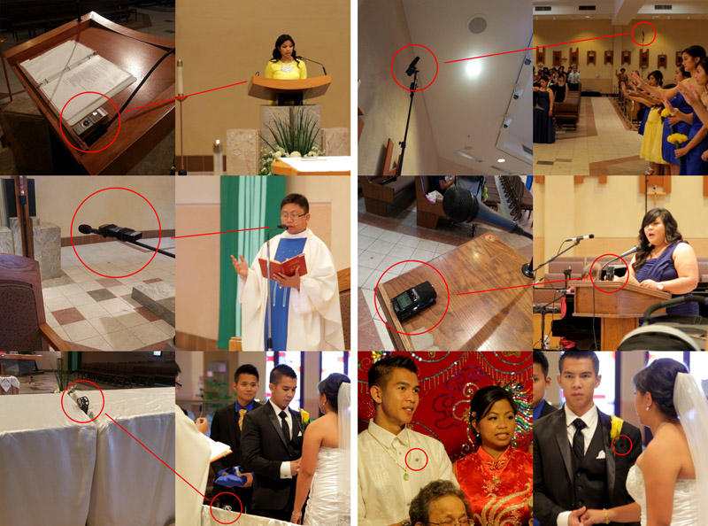

I put recorders everywhere at church. :)
Wasn't able to tap to the church feed. And the officiant refused to be mic'ed, here's my option :)
Capture Sound Every Way We Could At Church Weddings | L.A. Color Pros Blog
I put recorders everywhere at church. :)-church-mic-800.jpg
LA Color Pros Blog

That's the way I get my audio in church, since most recorders I use are about 100 dollar a piece it's a cheap way to secure your audio but no reason to overcharge :)

Sync is easy and automatic by PluralEyes.

Officiant refuses to be mic-ed yet is okay with having a bulky recorder taped on his microphone? I will never understand those people's mentality...
Good job on doing what it takes to acquire audio though. I would personally tape a lavalier on those microphones instead of just putting a recorder there but if you didn't have any available lavalier I guess it was still good thinking.
One thing I learned in time that will give me a higher success rate at getting the priest/officiant's cooperation is to tell the groom to come with me when I ask them to be mic-ed. They are usually nicer when they are in front of the couple. If they ever refuse I will turn to the groom right away and tell him that his video will sound like crap and ask him if he's okay that I don't use any of the priest's speeches. They're normally not okay with it so they will do the talking/convincing for me.

not if the two recorders shift out of sync over time - I've had to slow 1 audio track down to 99.97% to get close to a match - that's why I stick to Zooms now

I have a very old and cheap Olympus that do that. All the newer ones I have including both Olympus DM420 and the Sony ones, they won't drift.

Unless you can prove me wrong all external audio recorders drift, even if it's just a few frames over an hour but none can keep exact sync over that period of time.
I only wonder how pluraleyes does the syncing, it has to be setting a sync at the beginning of the recording, if it would check beginning and end it would not sync up any recorder.

I don't think I need to proof anything. All the clips I recorded (even those 3-4 hrs with H2n) don't drift. It can be seen easily on the time line. But it's true that all clocking device will drift one way or the other. In the old days where tapes were rolling mechanically on reels, there is a drop of frames every hour. That's why we have drop-frame time code from 30fps to 29.97fps.
As long as PluralEyes do the job for me fine, I have no complain. :)

Offcourse you don't but I think you shouldn't make claims that aren't true either without backing it up. I have had a discussion some time ago in the audio section claiming my recorders didn't drift either and the audio pro's said that this wasn't possible so I lined up my camera recording with a few of my recorders (like a yamaha c24, zoom h1, zoom h4 and I think I also used my tascam dr40.)
If I line up several videocamera's the audiowaveform stil matches after an hour but all my audio recorders did drift, even if it was a few frames, none kept perfect sync and I posted a framegrab of the drift. the audio guys said I was the luckiest guy on the planet to have external recorders that only drifted a few frames on a hour :)
So, unless you can show this I only can conclude your recorders do drift, even if you might barely hear it in short recordings, but if you would record 2-3 hours constantly you are bound to hear it. this means plural eyes probably only uses a reference point in the beginning to sync up.
