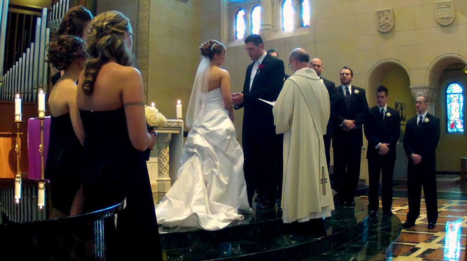

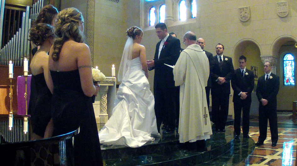

Just a follow up to my original post...Nigel mentioned Neat Video may be able to help...and I had always been meaning to get the plug in, just never have...until now. WOW. It's a dramatic difference, for sure. Probably not usable this time around, but that plug-in is great! Just wanted to share a before and after...
Neat Video can rescue footage that looks unusable. You have to be careful not to overdo it or the image ends up far too soft & people look like marshmallows. The downside is that it takes hours to run. I haven't thankfully had to use it in a while & their latest version may be faster but I wouldn't choose to use it unless I was desperate. The version I have is for Final Cut & now that I am using Premiere Pro I would need to buy another licence for that. have been using Red Giant's DeNoiser as it's part of the Magic Bullet Suite that I already own & appears as effective as Neat Video plus it's licensed for Premiere & FCP. I just had an email that the latest version (1.4) is up to 3X faster as it offloads work to the graphics card.
