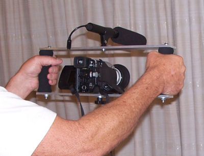

Just like Colin has made!! I had these when I was still shooting in the late 90's with Panny DS30's ..Just two strips of aluminium bar and two bits of pipe with cycle foam handle bar grips on them....you can tap a 1/4" hole in the bottom bar and screw in your quick release for your tripod too plus the top bar is great for mount other stuff onto!!
Here's mine back when I had the DS30's
Chris

thx for sharing this Chris, I am thinking about just one handle on the right side very close to the camera's body, I stll need to be able to fit it in a small bag and I also need to reach the zoom and record button with the same hand that holds the handle. I have some time this week to try some things out.
