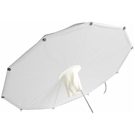

Tom its better to buy an umbrella reflector; much better for the these occasions and use a dimmer as well so you control the light.
http://www.adorama.com/images/large/PTSL54.jpg

I have an umbrella reflector and a nice softbox as well, but I'd rather use the barndoors because those allow me to control where my light is going. A reflector helps diffuse the light, but then it spills everywhere. Not saying it shouldn't be used .. just that I prefer to have control over where the light goes.
