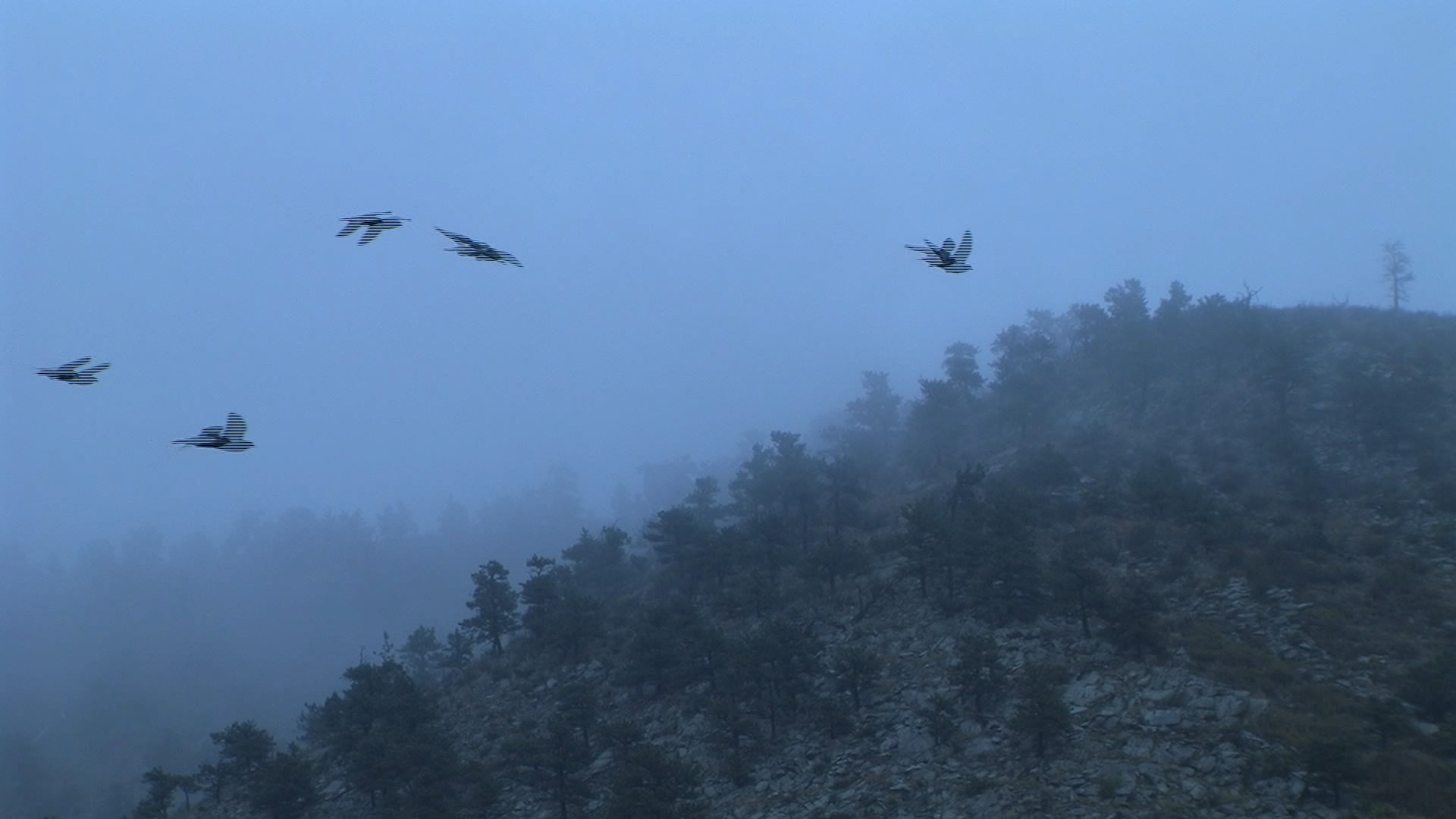

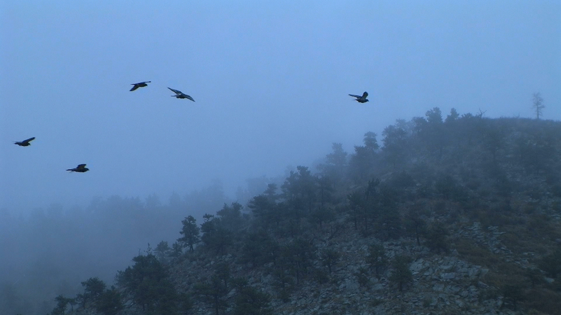

First, a bit more trial and I've seemed to hit something that works (for now). Digging into the manual I've learned that the camera films in i not p. I've also discovered that if I don't deinterlace on processing, it makes it much worse. Changing the codec again has helped a bit more.
Attachment 1 is the H264 version I thought did the trick at first but although vastly improved from my original version it still ghosts slightly.
Attachment 2 is an MP4 codec which seems to work.
Why this is I have no idea. The settings for both codecs are the same. I'm still uploading the raw TOD file to drop box (2 hours more), but I'm happy to cut it if you think I'm on the right track.

Dale: I know all too well you shoot birds and a master you are at it. Thanks so much for weighing in your thoughts and I will look into and try out everything you suggest. I have no idea if I can turn off resampling but I'll try and find out. Perhaps inherently this was the difference between the H264 and MP4 codecs in post processing that made the difference? Thanks also for the shutter speed tip in how you shoot birds in the air. I have a lot to work on between now and next February!

Wow Cat,
That's a vast improvement! How does the video look now? Is it smooth when the birds fly by?

Hey Bryce:
I think it looks just fine and I will upload a revised version after the voting so you can see for yourself :)

Huge differences between the original and the new version! Great improvements.
