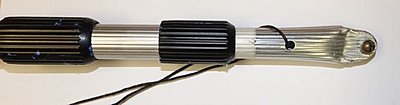

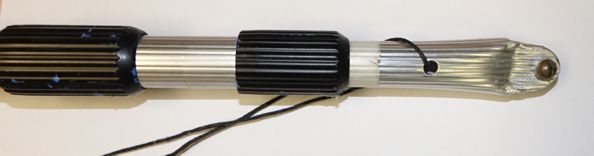

Trond if you are a bit handy you could make something like this. I found an old window cleaner with an aluminum telescopic handle and I adapted it for the GoPro: We hammered the end flat and drilled a hole in it. We also rounded the end so that the camera could be used at different angles. It fits into the standard fitting of the GoPro waterproof case. I can stand on a bridge and reach the water when it's fully extended. At the opposite end I glued on a round level like the ones used for leveling a caravan. It is useful if you want a level shot.
We also made a short one that is easy to carry in the camera bag for use in shallow water like fishponds.

Thank you, Marj!
The tip about the window cleaner bar sounds like worth trying out. Would have helped a lot!
