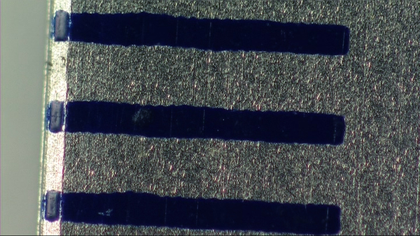

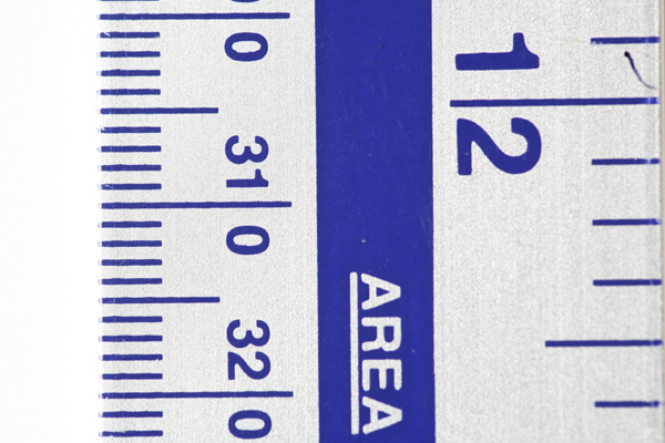

I can confirm the minimum focus distance remains the same with an ef adaptor on an XL2. By way of example I have attathced 2 images, video.jpg and dslr.jpg, these are both at 1:1 magnification with a 100mm macro lens, video made using the XL2 and dslr using a canon 5d, both full frame just resized for the web, the divisions are 1mm.
Hopefully the example says it all. I make no attempt at understanding the results!.

Thank you very much for your pics and confirmation! Its indeed a relief to find that the MFD is unchanged.
I should have made myself clearer in that the mag rate is unchanged but the final effect is the equal of the change in subject size (can be just simply put as cropping). DOF of course remains paper thin...Thanks alot once again and looking forward to more input from the others.

To gain the same 1:1 magnification as a DSLR, the XL2 using the same Macro lens would need to be a heck of lot longer distance away from the subject, and also have a lot more light or gain to match the exposure.
If both were set on tripods at the same distance from the subject, the XL2 would still provide more than a 7 X magnification factor compared the 5D.
