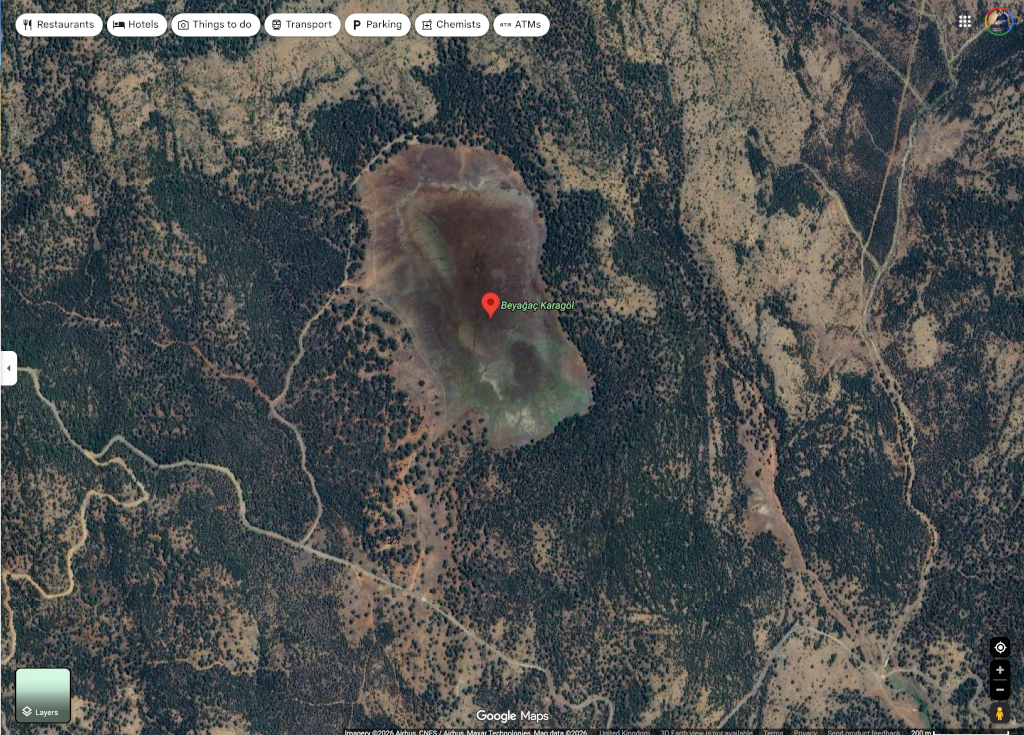

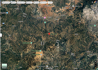

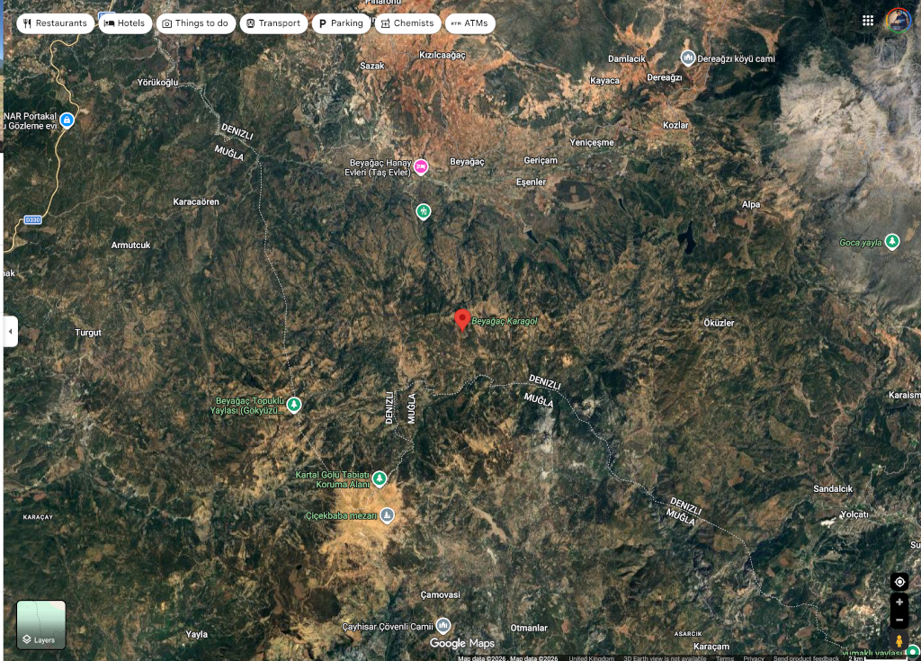

This is one of the locations in my plan... it's about 2 hours drive from the nearest town, a great astro spot and camping spot but no idea about logistics. Gona have to check that out!
- actually it looks like there's some kind of dirt road/track leading there so I may be in luck?
Oh well - we'll see lol
