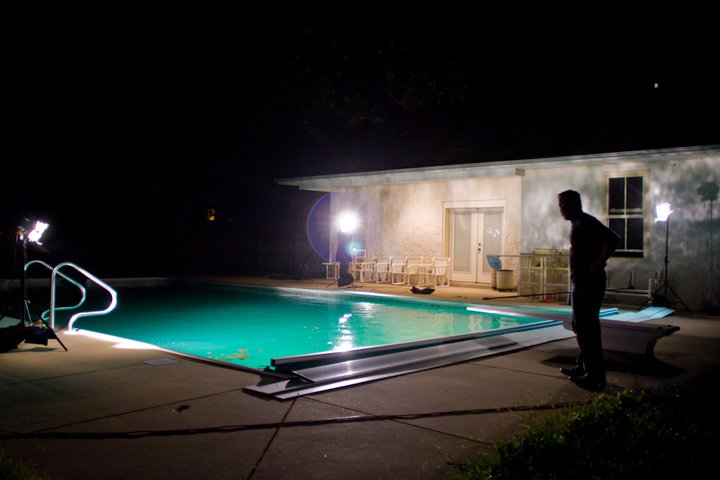

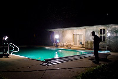

I 2nd the black plastic it works great. I recently did a shoot were we used a pool but didn't want it to look like a pool. We didn't do the black plastic since we were focused pretty close up. We did it at night though and used lighting and leaves to give it a more natural look. You can see it here:
It's the opening and like 35 secs in.
here is a pic of the setup.
Hope it helps.
