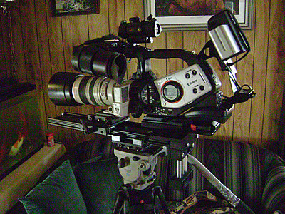

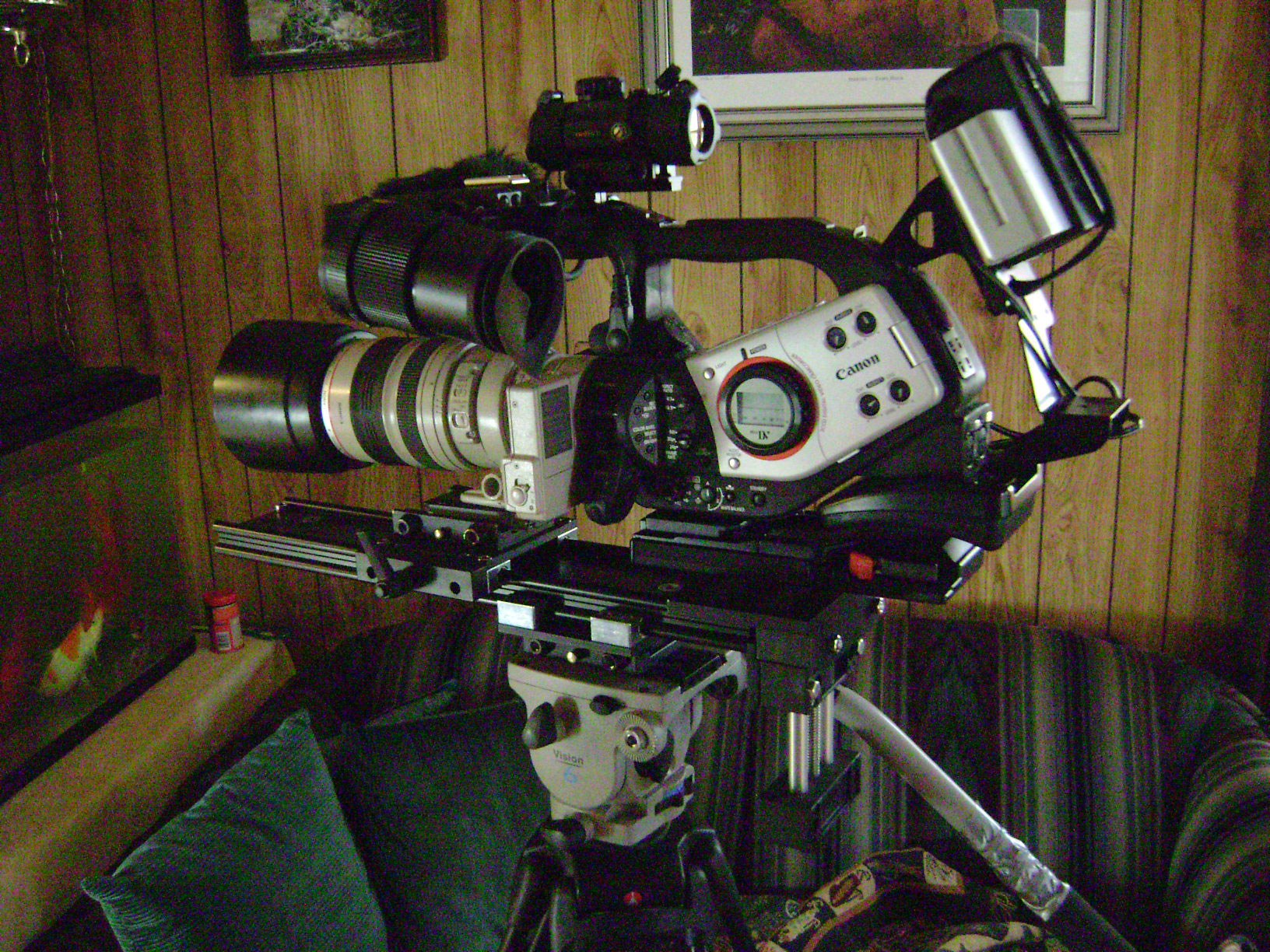

Old November 18th, 2008, 02:46 PM   #15
Location: Saskatchewan
Posts: 3,048
Ofer,
I am a little late on this thread but I thought I would share some thoughts:
A rail is one of themost important tools you have if you use big lenses!!
I tried a cava vision carbon rod rail first, just did not do the job (wasn't ment for that anyway)
I built a rail but it was to much of a pain to use but it was a mild improvement.
I broke down and had a rail made. wish I had done that two years back!! It was not cheap but it was worth every penny!!
While the rail is important as others have said, the legs and head are paramount too.
I use a vinten vision 6 and a gitzo 1380. I am partial to the vinten as i do not have to change springs!!
I have a farely heavey set of manfrotto legs. The combination of the three has made a huge difference.
Here in the canadian prairies we have punishing wind every day it seems!! 50 k today.
I shoot with lenses up to 500mm and if you follow the prior suggestions of getting low, block the wind in some fashion and use a rail you will be elated at the improvement!!!
Here is the picture of the rail I had made.
