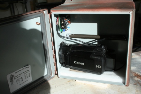

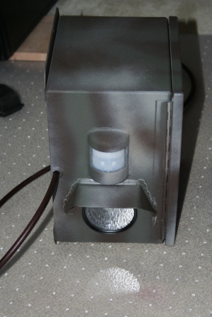

Old January 3rd, 2014, 07:35 PM   #71
Posts: 1,024
Re: Motion activated recording hardware
Ok, just another update for anyone interested in this stuff.
I have built a camera up with the hardware I have talked about in previous posts & will be setting it up in the field in the coming days.
Today I also finished a second setup using a second hand Canon Vixia HF S20 camcorder. This works perfectly with the motion activated hardware, however, the camera itself has a much narrower field of view than the Canon HF G10 used in the original setup, so getting things right with the setup of that camera will be a little more critical. The HF S20 also has an electronic lens hood, that snaps open & closed when the camera is powered on & off. There is a motor noise that goes along with it & I think it actually sounds a little like a squirrel so i'm hoping that's what any animal thinks too if & when they hear it!
As soon as I have some footage to share from any of these cameras I will post it here.
One other thing I have done with each of the camera setups is to make them work in the day time only. I am looking at possibly making a couple of cameras with a white LED array, but I have concerns that any light source would simply scare off any critters that come by the cameras, & also give away the cameras position to people that may want to make it their own!
Regards,
Bryce
Motion activated recording hardware-first-build-web-1-.jpg   Motion activated recording hardware-first-build-web-2-.jpg

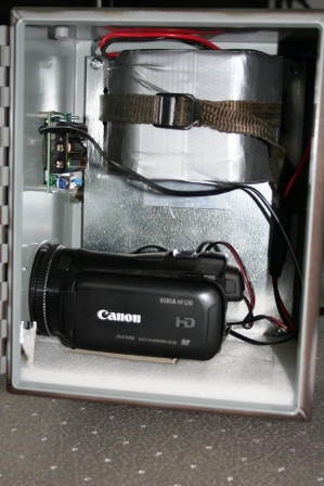

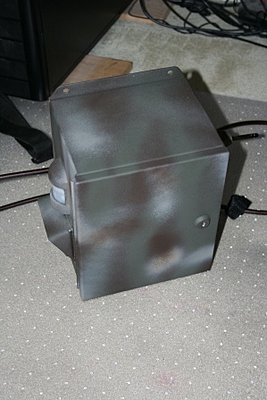

Old January 5th, 2014, 10:49 AM   #72
Posts: 1,024
Another quick update on this project. I finished my second camera so thought I would add a couple of pics.
Motion activated recording hardware-second-build-web-1-.jpg   Motion activated recording hardware-second-build-web-2-.jpg
