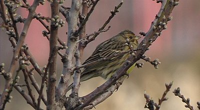

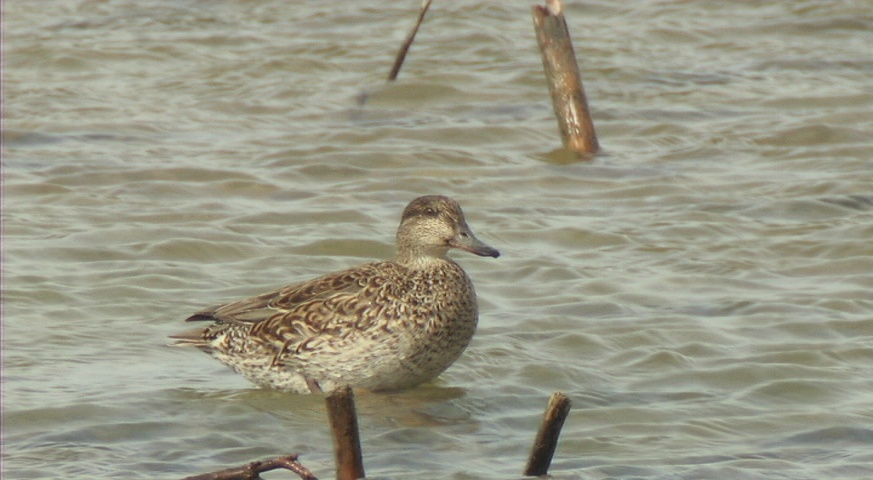

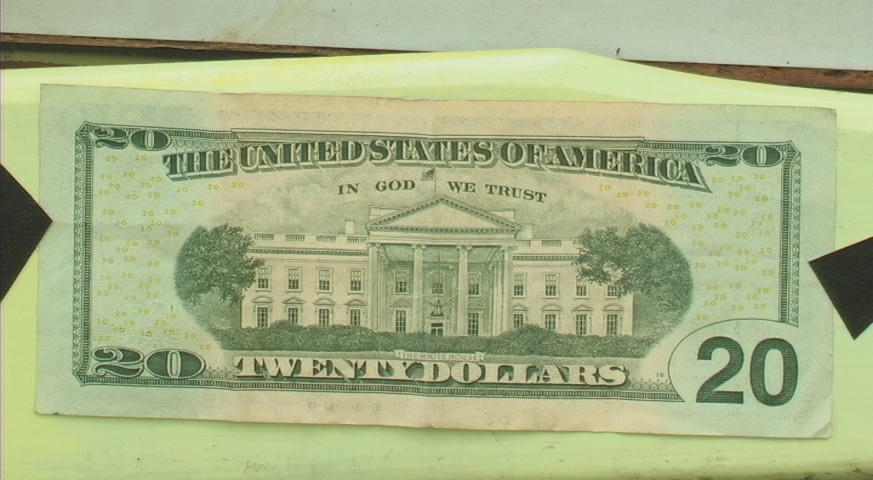

Hi Mat, guys.
I have experience with only two lenses, sigma 50-500 EX nikon fit ant canon 500/4.5 L non EF.
I use them a lot to shoot birds for the last two years (xl1s and xl2).
I was reluctant a bit to post because I don't have an answer to the question "which lens best for nature..." , actually , if I had to pick up one lens I would opt for sigma 100-300/4 EX that you own and use.
Any lens to choose from should have enough optical quality and good focusing ability , focusing should be tight and smooth with a long turn of the focusing wheel.
There are those lenses that can be attached to the camera without additional support. Few zooms (lower quality usually) that don't fit the bill, or 200mm prime lenses.
I once considered the sigma apo 70-300 but didn't even check image quality because focusing was rough, maybe someone have tried new nikon 70-300 vr ?
Any lens that fit this category would be valuable because you can very easily swap this lens with the stock lens.
The other bunch of lenses must have some kind of support.
I think that zooms wins hands down because of the nature of the media and the subject (be ready for the unexpected).
There are some instances that a prime lens can be useful as a second lens.
On the film era two of the converted slr lenses to be used for nature films where Canon 50-300/4.5 L (1.8kg) and 150-600/5.6 L (3.5kg).
Current lenses to be considered (longer than 200mm), are:
Canon 100-400 L
Sigma EX 100-300/4
Sigma EX 50-500
and I think there is also a 200-400/4 from nikon.
Never used the Canon 100-400 L ,but I am sure it is the most popular for the task. It is a push pull zoom that can deliver great results but suffers from sample variation problem.
Sigma 100-300/4 according to reviews on slr lens tests has great IQ one that rivals prime lenses at that range and works great even with TC, never used that one either.
The Sigma 50-500 EX is a lens I used a lot for almost two years it has some good qualities for the task ,but only yesterday I compared its resolution to the Canon 500/4.5 L.
The focusing on this lens is great better even than the prime, perfect for follow focus. Contrast is also great, and CA non existent.
As for resolution (my own non scientific tests) shows that on the best apertures this lens loose nothing to the prime lens on all focal lengths up to 420mm. On 480mm (I think it is the true maximum focal length) quality drops considerably. (nonetheless I like the canon image better)
Overall good performer and if you go only up to 420mm a very good alternative.
The canon 500/4.5 is great lens. One obvious advantage over the zoom lens is that it performs better on windy conditions.
adding a 1.4XTC (700mm) the lens loose some of the crispness but is still very sharp and much better than the Sigma 50-500 EX on the 500mm end.
Hope that helps the discussion .
To get the most out of your lens, be sure (I am sure that you know this) to stable the camera-lens combo perfectly on the tripod and get yourself a good sighting device.
As mentioned on previous posts I think focusing is a pitfall.
Last. Yesterday I spent an hour on testing the equipment (I think it was well spent), I found that if I have done this test from the beginning some of my past footage would have been better.
I actually found which aperture gave better IQ on each focal length, I thought that there is a difference between consecutive apertures but not so pronounced. This is a diffraction issue an its behavior is different than on slr cameras!!
Few observations...
On both lenses f11 was unacceptable, 420mm on the sigma gave excellent performance on f/8 but was terrible on f/5.6 or f/11 and the Canon 700mm performance best on f/11 f/22.

Very interesting reading sassi !! Many thanks for this. I have to say I do think the 100-300/f4 is a great lens although I do try and back off from the last 30mm as the image does seem to degrade there as well !

Posts: 1,413
Originally Posted by Sassi Haham View Post
...and the Canon 700mm performance best on f/11 f/22.
Sassi,
thanks for your excellent review about your lenses! Are you sure about your findings regarding what I have quoted here?
Even if you use a 1.4 extender how could such a small aperture be the best!? My findings regarding the 500mm f4.5 is that it is sharpest between f7.3-f11.
Also to maintain the best and sharpest aera, I've using different grades of ND's. Shutter speed normally is 1/50 (PAL), so ND is very important to adjust the amount of light to hit the ccd. ND 0.3, 0.6 and 0.9 is my most used set for the ef-lenses.
- Per Johan
