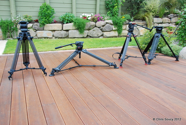

There's no question, the "spreader - less" sticks will go lower, almost flat to the ground, especially if you buy the sometimes available "short" version of the clamp knob, Sachtler comes to mind, though their spreaders don't actually let you get all that low.
The down side is that pretty well all the "spreader - less" sticks are 1:1:1:1 designs, which really aren't all that stable, no matter how you configure them.
The lowest proper 2:2:1 sticks I've ever tested are the Manfrotto 546B sticks being rolled out under the newish 504HD head.
They're great sticks, just marginally less rigid than the Vinten ones under the Vb heads, which is good indeed.
HOWEVER, a big caveat here is the spreader itself. The sticks are good, the spreader is a complete heap of sh*t, and I don't say that lightly.
BUT, boy, can they go low (just don't blame me if you become a raving alcoholic having tried to get that spreader to retract from fully open to closed - it is purpose built to drive anyone to drink).
See the attached pic for an example. The line up is a Vinten Vision blue, Manfrotto 546/ 504HD, Libec RS250 and Sachtler 75 CF's with FSB 6 head (not neccessarily in that order)
Guess which one is the 546.
If you want more info on the Manfrotto, check out my review in the Articles section here on DVinfo.
CS
PS: Yes, they are all at minimum height, so no tom foolery going on.
