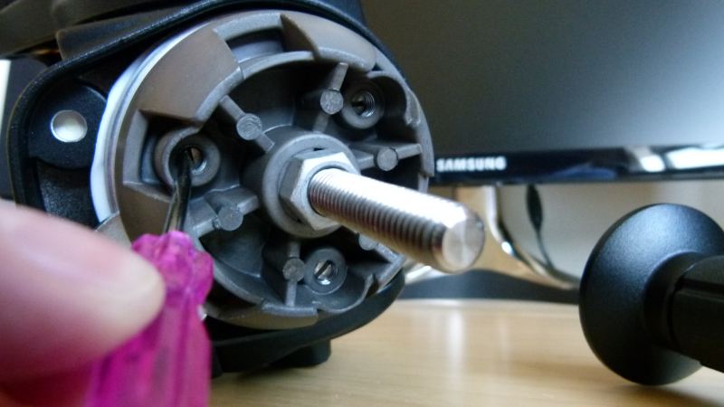

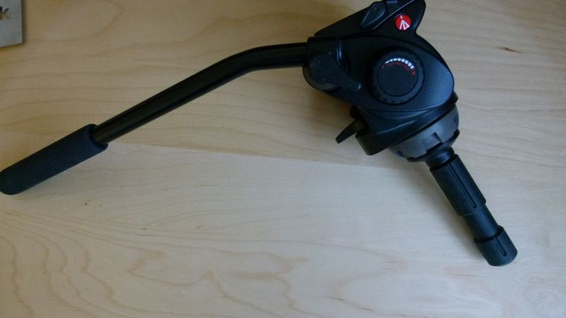

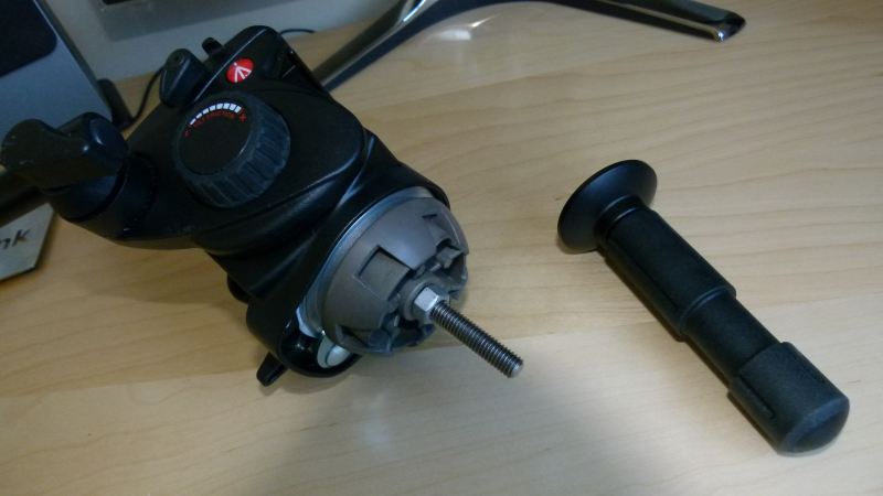

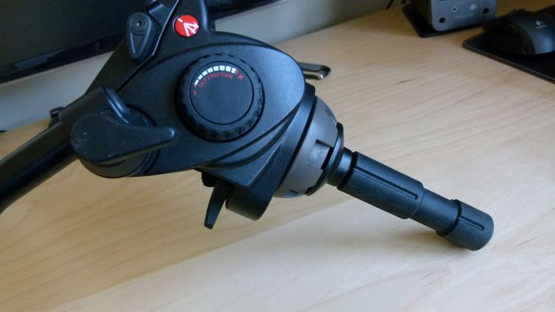

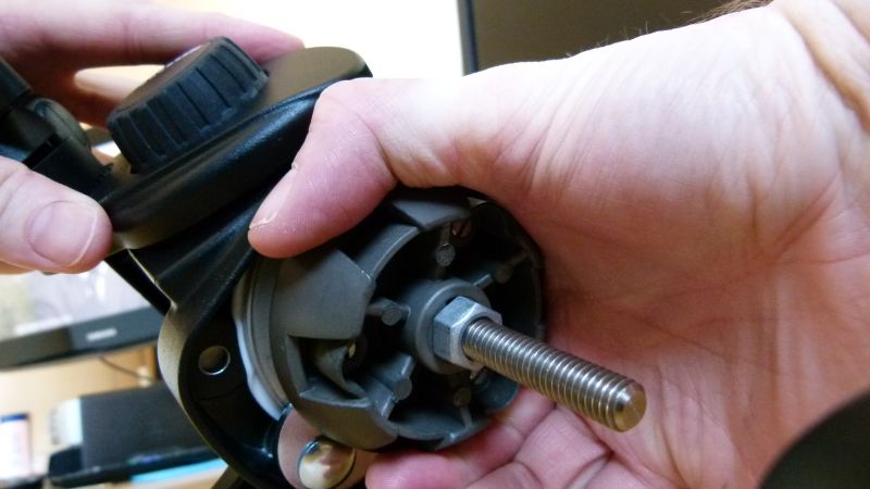

Just check that your 501HDV is the same as mine. See the attached photos!
They show the head before the handle is removed, with the handle removed, the screws being removed, and finally the head being unscrewed from the base.
I am gripping the whole head with my left hand, and twisting the bowl counter-clockwise with my right hand.
As I said, it can be very hard to do this the first time. If your bowl arrangement is different to mine, then you might need to wait for someone else to help!
