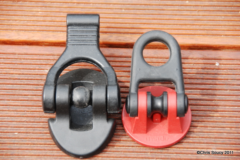

The easiest way to do this is to show you.
The Sachtler spikes are finer and closer together than the Manfrotto pattern, plus the thong attach ledge on the Sachtler is much much closer to the floor, hence the much reduced thong length.
The Manfrotto pattern (tho' actually the Vinten boots) on the left, the red Sachtler on the right.
CS

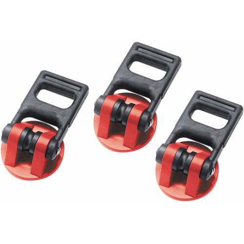

Looks like those red feet go to the DA 75. I'm using a CF 100, which uses the feet shown below. It seems I might still have an issue with loose straps on the Manfrottos.
Finding a kludge for loose straps might be more elegant than the system I am working on now - using PVC, tree branches and duct tape.
Unless you see another reason they might fly across the room and take someone's eye out, I'll order a set (B&H $23.30 with shipping) and dissect them.

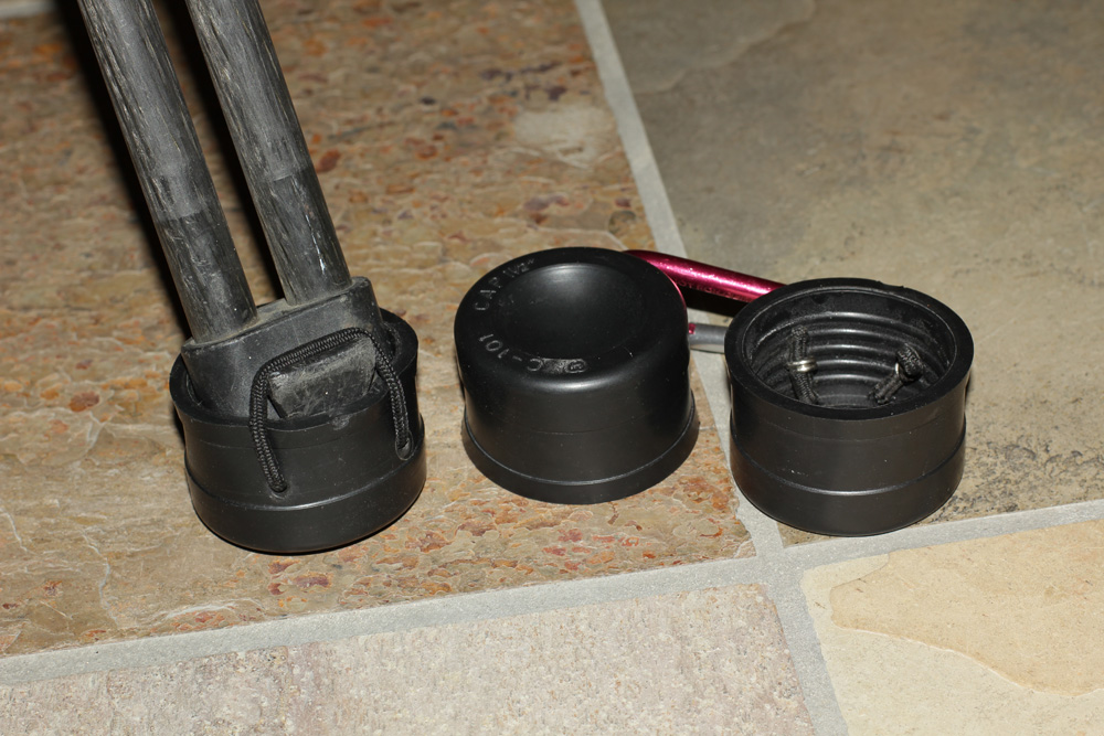

Oddly, success happened. With a few minutes of dragging my CF 100 around the local home improvement store upside-down, I discovered a 1-1/2" PVC or ABS pipe coupling would snap over the spikes and hold tight.
Hmm. A 1-1/2" cap would be a great, almost one piece solution (still need a rubber pad), but the spikes were too deep for a cap to snap over the lower leg bracket. Rats.
Looking for black ABS pipe couplings and caps in the Drain-Waste-Vent section, I noticed 1-1/2" black rubber pipe caps. Being more flexible, they still snap fit, but less reliably so these would need a bungee strap. But hey, no paint, glue, finding/fitting rubber pads. It can't possibly be this easy.
Bought three for $2.70 each, including a lovely stainless hose clamp on each. Not sure what I will do with the FREE hose clamps, but you can't have too many spare hose clamps, right?
Punched two holes in each cap (already had the punch) and crimped a short piece of small bungee (already had the bungee) onto each one. Voila! The $9.00 Sachtler dancing slippers. No A-team of white mice required.
