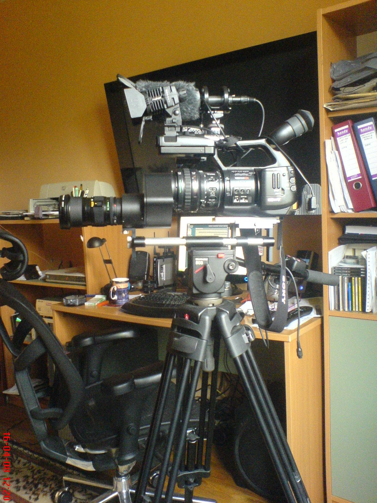

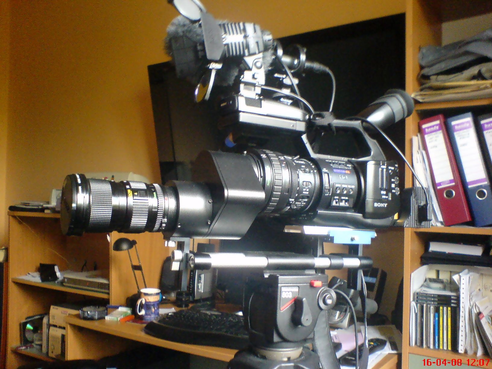

While of course not being the greatest head in the world, I can confirm that the older Manfrotto 503 is doing fine with all this additional weight on it - it actually feels smoother than with the camera alone! Currently, mine carries the camera with Letus Extreme and Letus rails system, the long Canon 35-105mm zoom, the Bebob Coco-EX adapter for BP-60, feeding a PAG light (in addition to the camera of course), plus additional mic shock mount (from Rode) and the Senny wireless receiver, both mounted on the J-Rod. When I get a mattebox, I'm going to fix the additional 15 cm Letus rail extenders in the front, and the whole rig will be moved back on the Letus QR mount, to find tthe new balance position (currently is balanced perfectly).
PS: Can anyone advise on a mattebox that would fit BOTH a rig on rails, like the one depicted here (I'm using mostly Canon lenses with 52mm or 72mm thread sizes), AND the camera on its own?
Tripod for EX1 + Letus Extreme/Ultimate-my-rig-2.jpg   Tripod for EX1 + Letus Extreme/Ultimate-my-rig-3.jpg

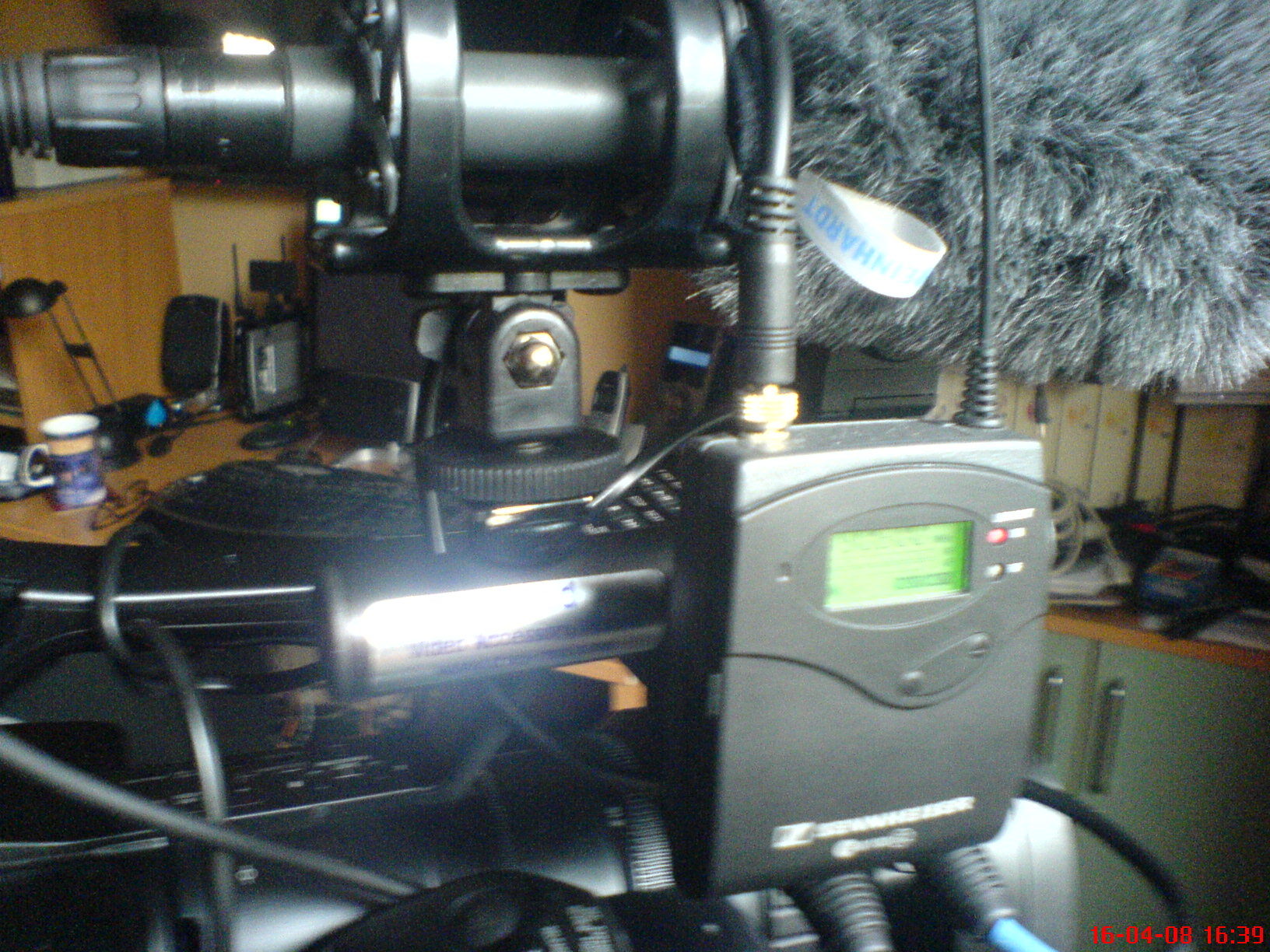

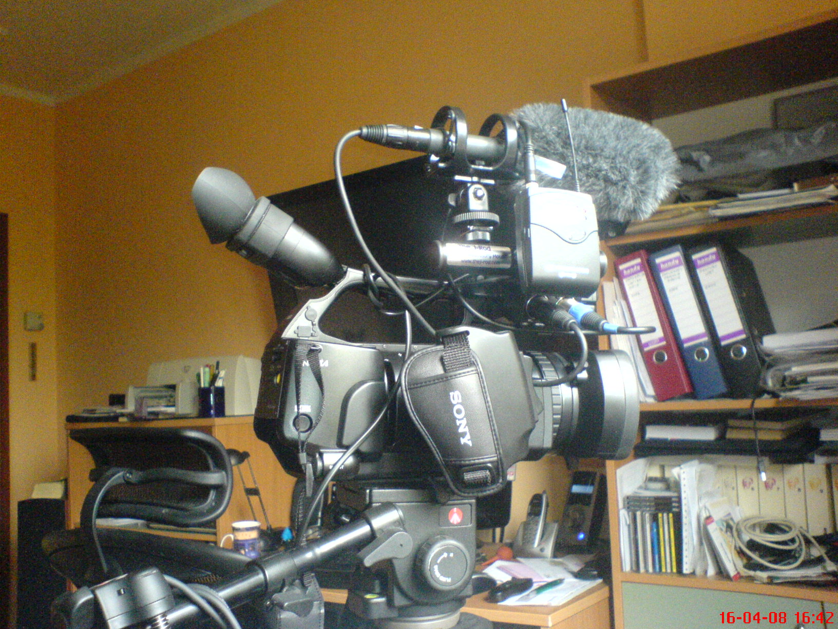

PIOTR, Would you be able to post images showing your gear from the other side? (with the mic section)
Sure thing Attila - I hope you will forgive the low quality (I've made them with my mobile; without the Letus this time).
It may be worth noting that even though I'd bought the J-Rode accessory almost a year ago, I never used it so far because the supplied Azden shockmount has too long spread for my short mics. Recently I have replaced it with the Rode SM3, and all works very nice (with Letus vibrating, putting the mic higher and in the additional rubber suspension helps a bit; still the recorded audio can be used fro reference only - but with the Sennheiser wireless, it's OK)>

Thanks a lot Piotr for your fast action,
I'm using a long mic from Azden too and I think its suspension is good enough for my purposes. ( TV NEWS and short features)
What Sennheiser wireless system is hanging there on the gear?
(I'm sorry but I can't read it out from the image :-)

Yep - for long shotguns, the Azden mount supplied with J-Rod will be perfect. However, a word of caution: the assembly (J-rod plus a long mic plus a wireless) can be too heavy for the EX1's mic holder! You might consider modifying it, as Bob Grant has and shown in one of the threads here (do a search and you will find the picture).
As to my wireless, it's the Sennheiser EW 100 G2 system.
And yes, he quality of the pictures makes it impossible to read the name on it - but I hope you got the idea :)
