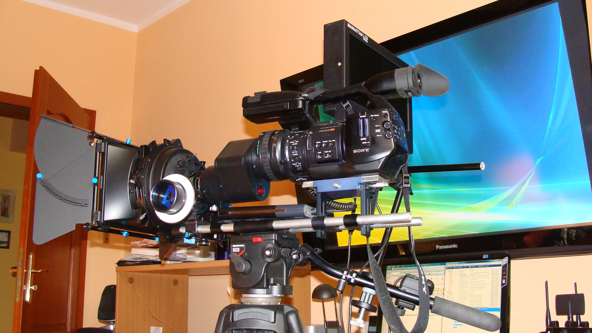

Old December 21st, 2008, 08:42 AM   #158
Location: Poland
Posts: 4,086
BTW, looking at my own setup above, I somehow have some doubts whether something as long and heavy can be fixed to the Sachtler DV 8 (or DV 8/100, for that matter) using this proprietary QR plate rather than a full-sized, slide-through one:

Yep, "no compromise" it is.
Funny thing is, a serious scrute of that photo tells me you don't take any prisoners either.
You're gonna have video wannabees drooling all over their keyboards right across the planet.
Which does kinda beg the inevitable: "Why are you asking the 75 mm vs. 100 mm" question.
The sheer length of that setup screams 100 mm.
Then take into account the sheer mass of that system and 100 mm is a forgone conclusion.
You don't appear to have compromised on one single thing with that rig, don't spoil it for the wrong support choice.

So now that you've seen my rig, you're absolutely right - I'm not even trying to be mobile with it. Some 90% of its use is shooting live music performances. So of course my tripod must be as solid as a rock, but with this weight and size of the whole rig, whether the tripod will add one 1kg more or less is not important at all.
This is why I still am considering the Manfrotto 526, which is 1/2 price of the Sachtler DV 8/100. And of course, it's also 100 mm ball. The only remaining issue is the legs; do you find the 528 really that much better that the more mobile 350, or 515?
Your opinion is very important to me Chris, because you're right: I'm never compromising if there is even the slightest chance to avoid compromising. Let me go back to where we started, and express my dilemma again:
- for the rig as in the picture above, and shooting music (usually multi-camera shots, with my own being the "main" camera, i.e. always on, lots of close-ups, only some panning or tilting,) - should I make every effort possible and buy the Sachtler DV 8/100 on CF sticks, or the Manfrotto 526 (on which legs?), and for the difference in price invest into a really good microphone, for instance?
PS. I fogott about the third possibility that you've mentioned - the DV 8/100 on the 528 sticks...

yes and definitely yes!
i looked at your picture and i actually have 3 more items on my DV8/100 than you.
in the front, i have a Zylight90 (led light) with chimera box and fasteners (to the rails) pulling a pair of tekkeon batteries.
a schoeps mike on a telescopic mount.
so the front of my system is rather loaded and the sachtler dv8/100 counterbalances this with room to spare.
this setup as you know is for stage work and not my run and gun. for that, i bring along either a pair of sober hands or a bogen manfrotto 561b monopod with that fantastic ground rotating mechanism
Bogen / Manfrotto | 561B Fluid Video Monopod | 561B | B&H Photo
the above is great for terrains, sports, and kids where it's just the camera (ex1 sized) and a self powered led light or mike.
so piotr, others have confirmed what i will also tell you.
with what you do, 100mm is the minimum and there is reason to go even higher than that, as you have a lot of stuff! 150mm is not out of the question here.
since you are considering legs in the price range of the gitzo gt3530ls, which i sometimes use with my sachtler dv8/100 with the gitzo 100mm ball mount, you have a setup with a lot of height and movement flexibility if you ever needed it and up to 40lbs.
hope you make the best choice for yourself!
paul
sachtler: Fluid heads
Paul Chiu is offline   Reply With Quote
Old December 22nd, 2008, 05:14 AM   #165
Location: Poland
Posts: 4,086
Yes Paul, 100 mm it will be for sure...
Actually, my full setup is also even heavier than the one depicted above; the light in the cold shoe and a (shotgun plus radio receiver) on J-rod (front), plus the PAG 100 Wh battery at the very back end, on the free portion of rails sticking there :)
Today, I had a chance to put the camera alone on the Manfrotto 526; the head feels solid, but it was mounted on the lightweight 515 stick - even with the minimal drag applied, all panning and tilting move the whole tripod! So definitely, if I go for the 526, I need heavier stick (maybe even the heavy-duty 528, as Chris suggests).
But if I go with the Sachtler DV 8/100 on the CF legs, won't the same happen? I mean, with my full rig's over 10 kgs it should be loaded enough to not move the whole tripod when panning/tilting; but when I put the naked camera on it, won't the CF stick be too lightweight?
I AM using the very handy Manfrotto pouch, hanging in the middle of the legs, with some heavy stuff in it - it does stabilize the legs, but still... It looks like with heavy-duty system I need a heavy-duty head, which in turn requires a very heavy tripod...
PS. Incidentally, I'm also using the 561B monopod for those casual shots.
