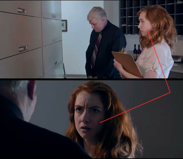

What's the point of only looking at it when your at home editing when you can't fix it?
This is obvious stuff, look at her face. Not only is it too dark it's light from opposite direction and doesn't even remotely look like the first shot.

In these two shots (without going back through the movie) were they cut together? The lighting is different but they've completely changed positions too - the lighting is just odd. her left cheek in shadow, but her hair and the guys face are bright? Why on earth was it lit like this?

Cross lighting...her hair light is his key from another angle and it wasn't changed for the reverse

Re: Would using a star filter for cinematography be too weird?
I am not sure, that shoot was a few years ago now. One thing I noticed is that when I shoot on the camera, the image is very flat and faded looking on the monitor. That is what it looked like in it's flat S-log 3 format.
So I didn't notice how apparent the difference in shadow was, until after the color grading later. The contrast, was not near as high before color grading. Next time I can put a LUT over the footage so the lighting contrast will be more obvious during shooting, if that's best.
I know it's hard to believe, I took frame captures from the same scene a few seconds apart.

Well I think it's because of the S-log 3 formage being so flat, that you can hardly even see the shadow patterns as a result, until grading later.

You may have gotten away with the lighting if you'd put in a turn to face the male character, because it would've fitted in with light not coming from the direction of the filing cabinet.
