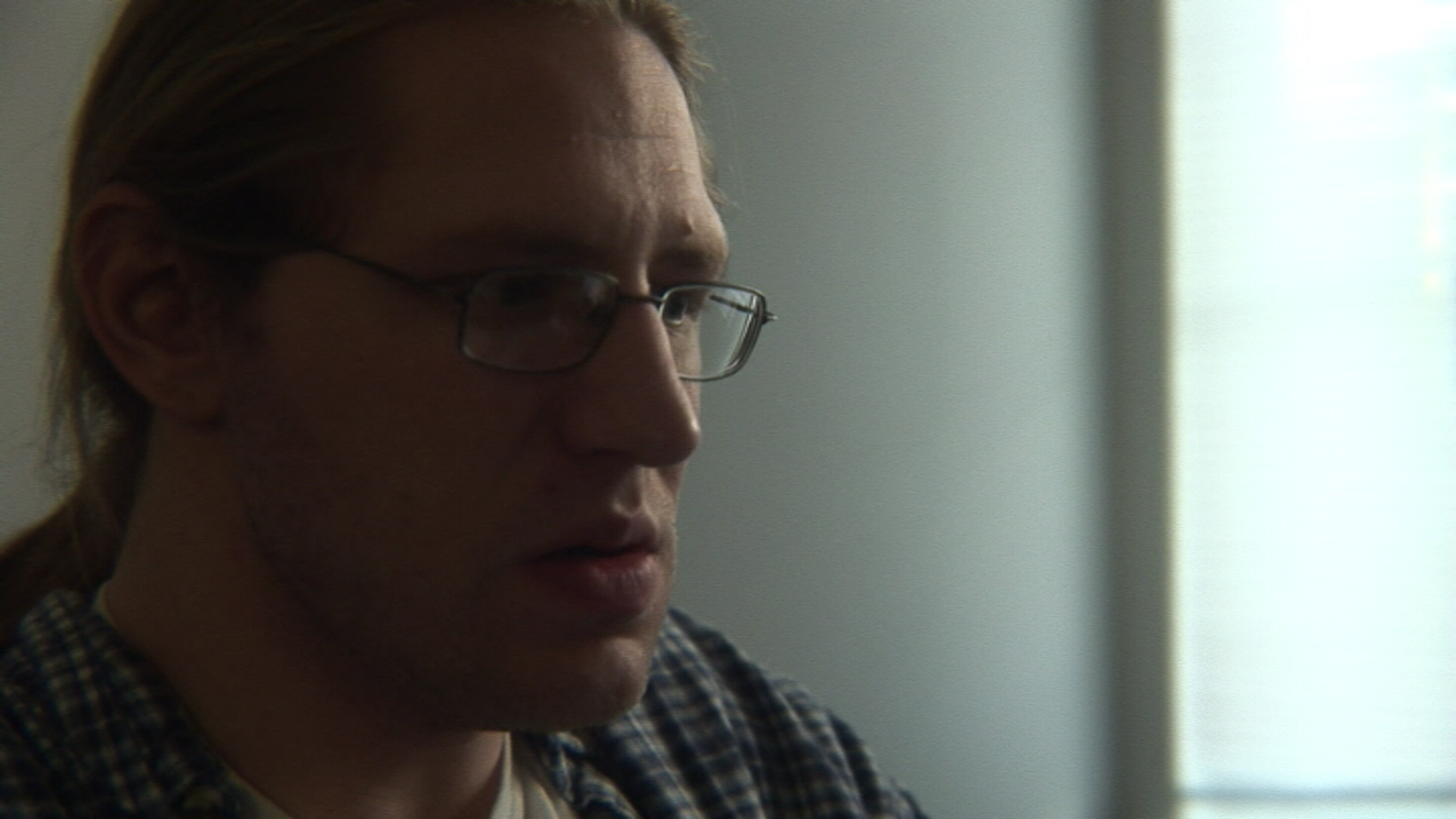

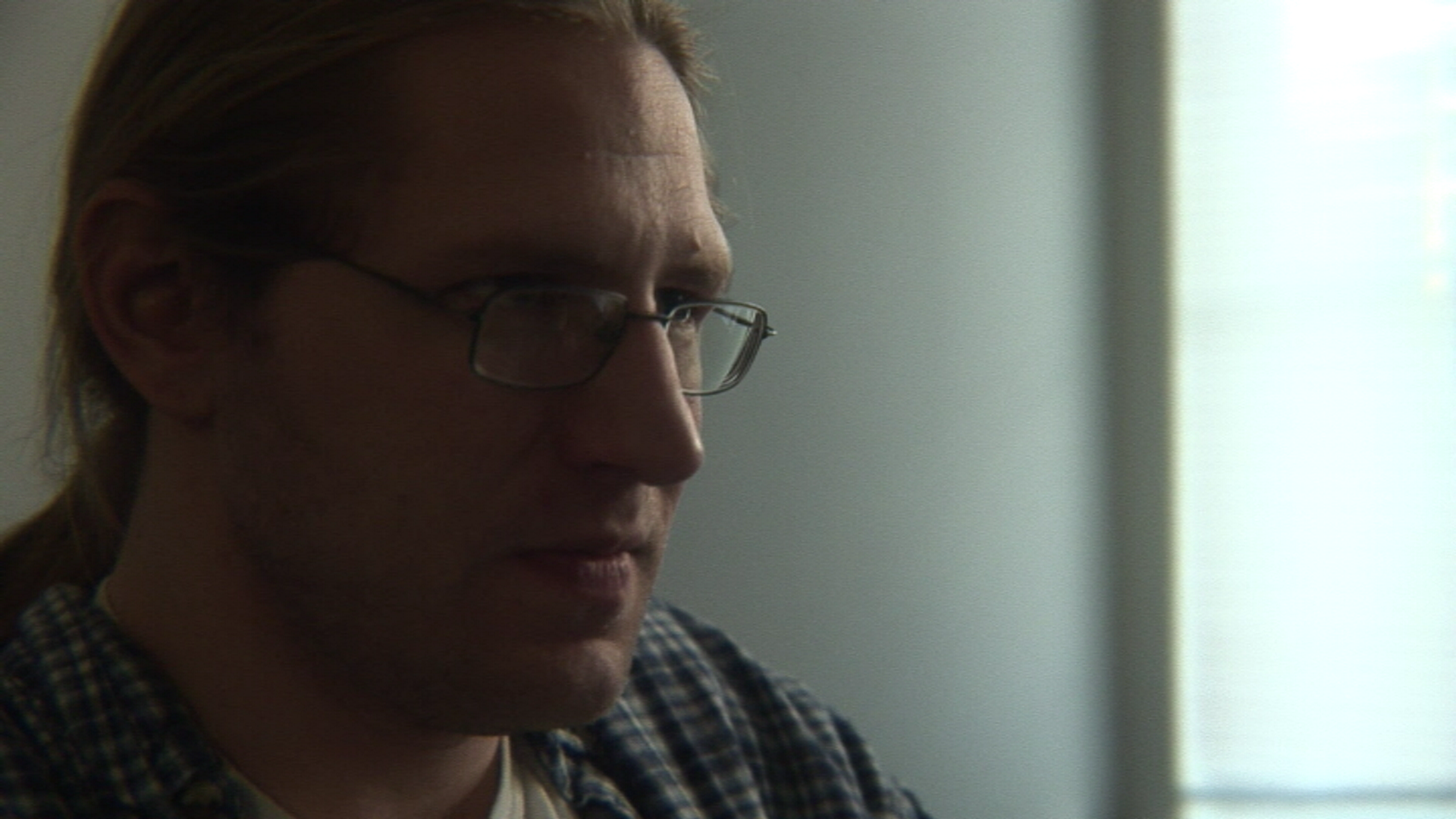

I use DVFilm Maker to deinterlace from 60i to 24p. I think it's the best/smartest deinterlacer for that purpose available, at this cost anyway. I'm curious how much detail you're losing with your deinterlacer; with Maker, I'm losing virtually none. See the attached pictures; completely uncompressed, straight-from-Ppro framegrabs. I suppose the proof is really in the more motion-crazy shots however.
The best workflow for me in terms of quality is to convert 60i -> 24p with Maker, then edit in a 24p timeline.
I don't do much color correction but when I do it's one of the last things, after deinterlacing definitely.
shoot progressive or deinterlace in post?-laugh-track-24p.bmp   shoot progressive or deinterlace in post?-laugh-track-60i.bmp
