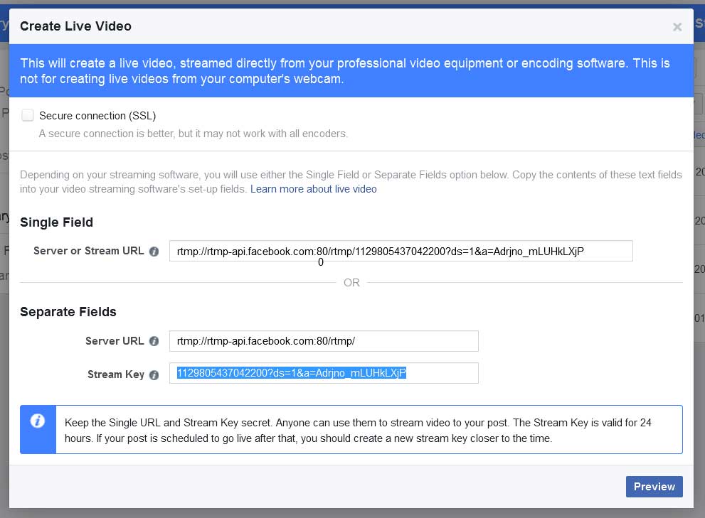

A couple of weeks ago I had done some extensive Googling for information about the Facebook Live streaming product that they famously had some difficulties with at the time of launch.
If it has been rolled out to your Facebook page, you can select the "Publishing Tools" menu and then click on "Video Library" where you can "Create live videos with professional video equipment from your Video Library" yada yada yada.
This is the screen of info you get when you click on it, including a server and a stream key for targeting your streaming device to.
Andrew

Update: the second time you go there you will have to select the 'live' button in the top right corner of the interface for the video section.
There is a preview function, with the interesting instruction of "Don't put third-party video ads in your live video. For example, don't include bumpers, pre-roll, mid-roll or post-roll." yet as one article has pointed out, Facebook Live needs a waiting room of sorts.
Myself, I'd be inclined to put in a countdown timer with graphic for the two or three minutes prior to an event start.
