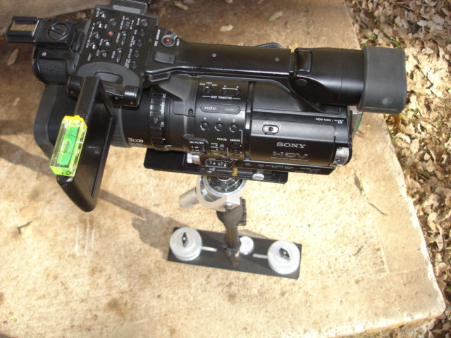

We have found that for best balance (static and dynamic) the bottom weights should be equal in number and equal distance from the post. I notice that some of your weights are closer to the post than the ones on the other side.
When the weight plate is balanced as above, the rest of the balancing is done by moving the camera stage. As a matter of fact, when we have the camera and camera stage off our system and spin the post and weight plate, it spins straight (no wobble).
Does your camera swing back to the top when you hold the sled horizontal and let go (again-carefully)?

Thank you for your assistance and patience. I spent another few hours tonight tweaking my glidecam. I took a few more pics (smaller :) ) of where I'm at with it.
Question: How do I know if I have not enough or too many weights on the sled? I have 10 on the front and 10 on the back (that's how many came with the glidecam).

Tim,
I notice you are using a quick release. Good idea.
In order to answer your question I need you to please answer this question...While holding the handle pick up the sled and hold it horizontal. When you let go, what does it do?
I've attached a video that shows what I'm talking about. It's low quality but it gets the idea over. If the video doesn't play correctly, right click on it and "Save Target as..."
